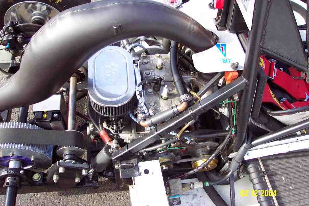

I used to use the high temp copper RTV on my 2-stroke racing exhaust right where the pipe meets the exhaust manifold donut.
It worked for a while then tended to blow out all at once. You're right about the exhaust putty hardening too. Both would work as a maintenance item - meaning, you'll need to revisit the leak every couple of years.
Of course when I used it, it was subject to a lot of vibration and bouncing around. This engine normally ran around 8-9Krpm and EGT was around 1280F.
