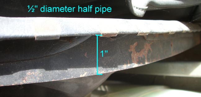

The piece would be difficult but not impossible to make. It is bent in the shape of the channel, the flat portion is about 1 1/4" long and the top of the piece is formed into a semicircle cross section. To make one you would have to bend some tubing in the shape of the channel and cut it in half and weld it to a flat section in the shape of the channel. Have a good day!

If you can't find one, the way John outlined isn't a bad way to go. Though cutting the tube along it's length could be a challenge and you'd have to have competent welding skills. Another method would be to build a form in the shape of the drain channel, place a piece of 18ga sheet metal against it and hammer form the top radius. That of course has its own difficulties. Here is a lame photo of that piece with some dimensions. The material looks like it is either 20 or 18 gauge steel. I'd have to put a mic on it to be sure.
