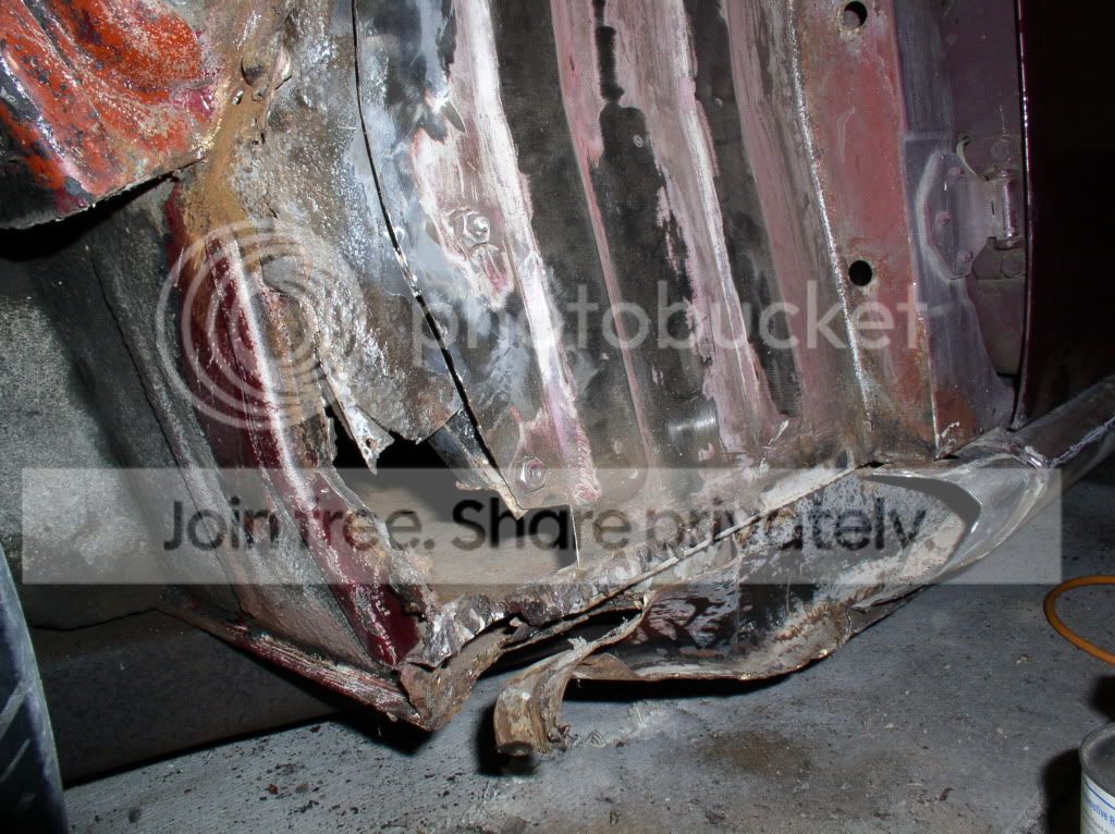

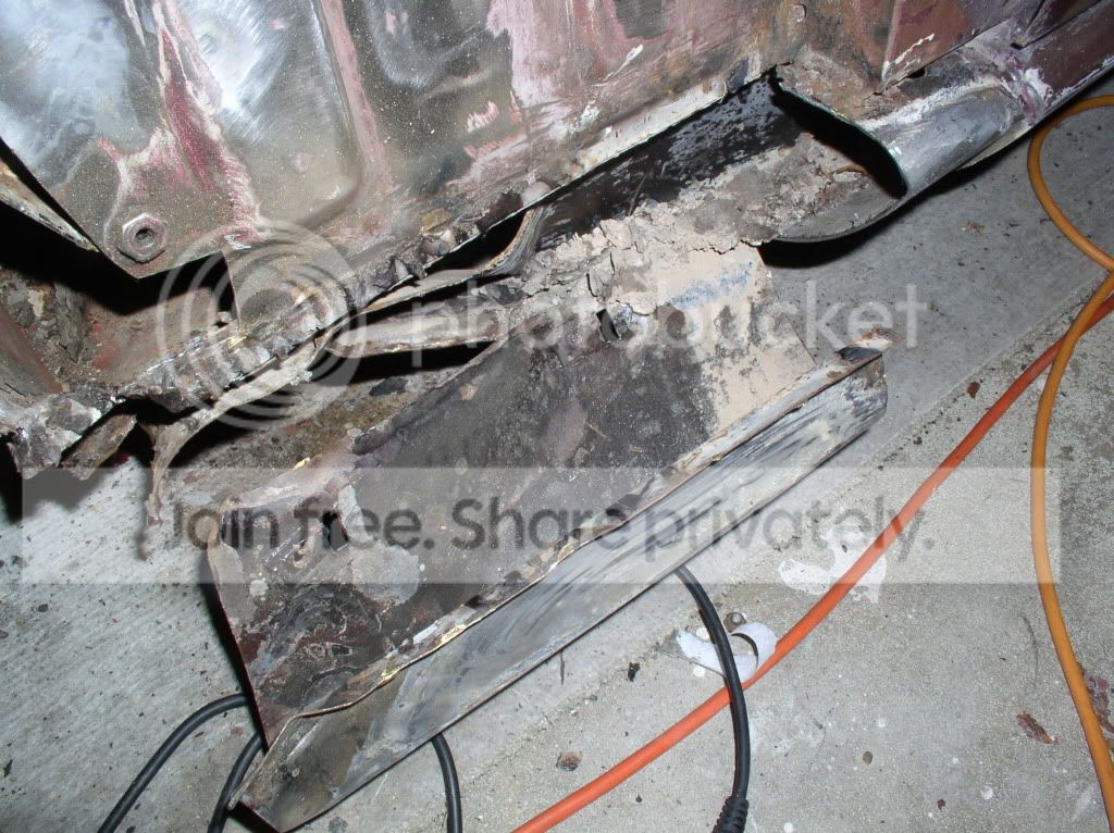

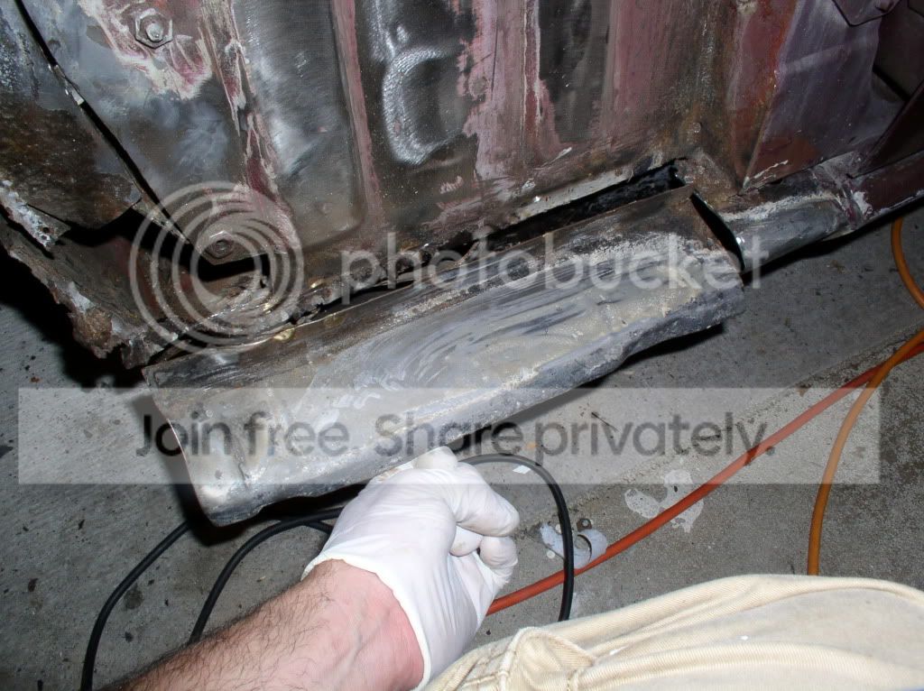

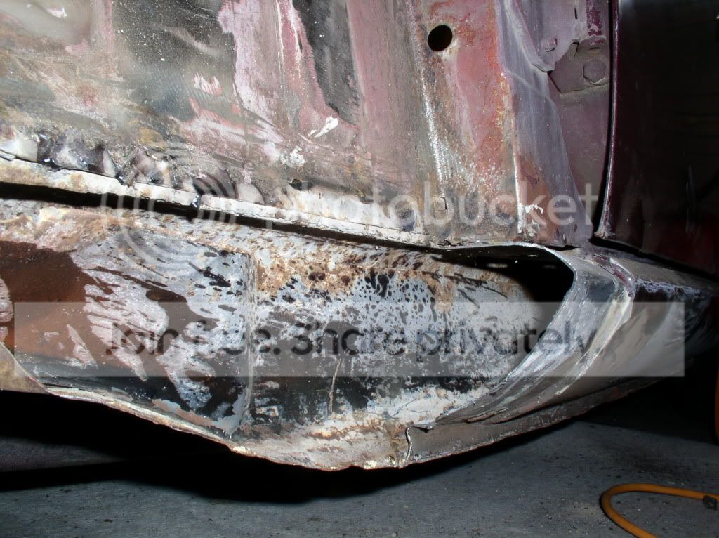

You may remember that this is the TR6 that went up and over the uHaul trailer some months ago.
Since the sills were bent beyond repair and the front bulkhead section was iffy, not to mention the very front inner sills being a bit crusty, it was time to loose the front section of the sill.

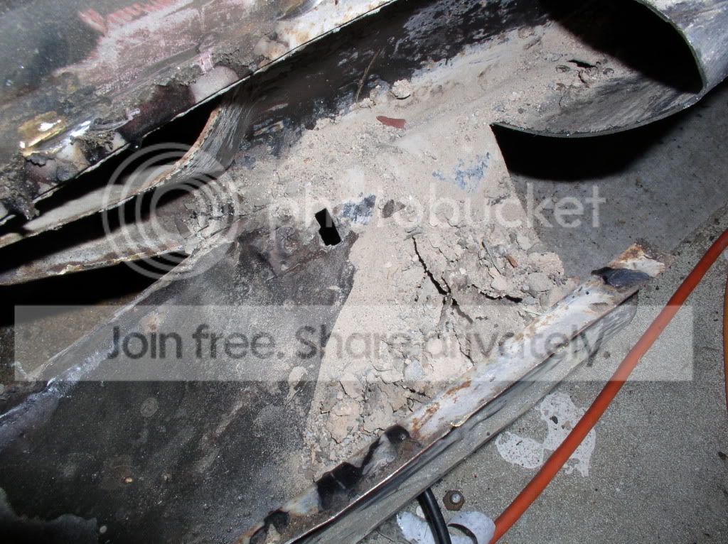

Anyone need yard fill? There was a ton of dirt pushed up into the inner sills.

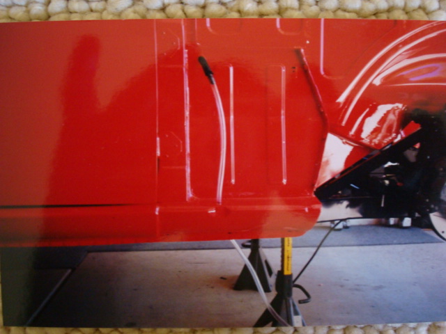

A trick to help prevent future rust. Sorry about poor picture quality.

Looks pretty grungy, but as far as sills go, they look a lot more solid than others I've seen. Not a bad place to splice in the front section either, should be nicely hidden with the fender.

I'm sure mine are not too different. One of these days when I'm brave enough, I'll get in there and see how bad it really is. :pukeface: And I'm afraid more of rust flakes than dirt. :nonod:
Hi guys - yeah, the sills could be much worse. Thanks for the drain tube picture Keith, definitely going that way. I was hoping sectioning it there would give me the best chance of hiding any welding ugliness (which my skills will produce a lot of).
I did the drain tubes on mine, but took them out of the front inner wheel well panel.
