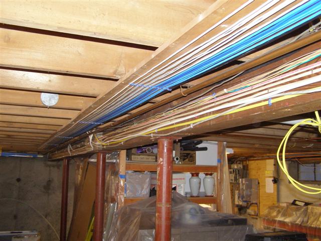

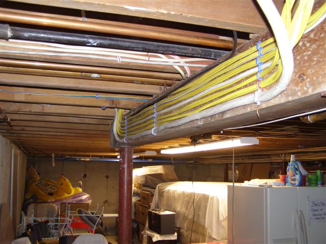

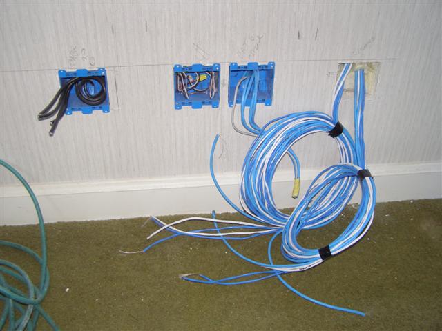

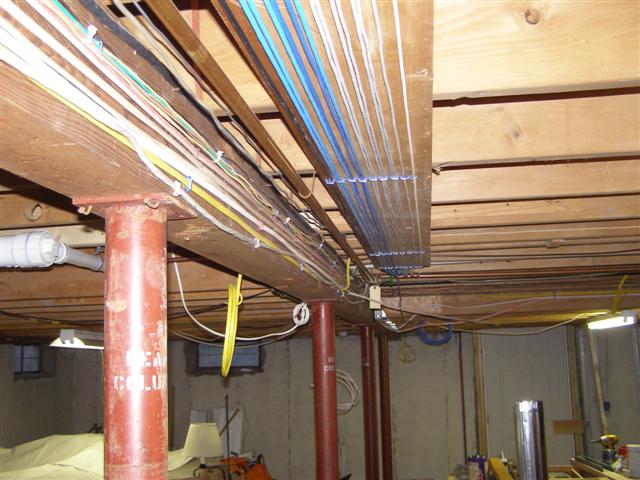

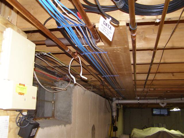

And make sure that they keep the coax, data and phone away from the power lines, even if it is shielded. I only have a few pics of the work in progress at my house, because I'm not done yet. More to follow when completed.
The last picture will be the wiring for the entertainment center. All wiring goes to the individual room speaker controls is home run with both CAT6 and shielded speaker wire and there are (4) coax lines run in for Cable, FM Antenna in attic, HDTV Antenna in attic and a spare to the attic for who knows what. I also have (3) CAT lines run to the center from the network for streaming audio and video, direct internet connection to the TV and a spare.
