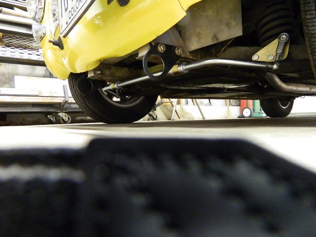

I doubt those were intended as hold-downs. (At least I've never heard that explanation for them) There's not much structure there, just flat sheet metal, and I sure wouldn't trust securing my car in that fashion. Later Sprites had tow hook brackets bolted to the frame horns using the bumper bolts. Brackets could be swapped or custom made (see pic). Over the tires or with axle straps (looks like a short seat belt) would be much better. I use the tow hooks and axle straps when towing the race car on my trailer.

Those nice tow hooks you showed are you producing those tow hooks? Will they work with a front tilt bonnet?
Gerard, how about the source of that nifty anti sway bar?? :playful:
I didn't notice the adjustable Sway Bar. Trick stuff.
That's a 5 speed customer in Colorado. *The bar is from Winner's Circle.*
As far as the tow hooks, I don't make them because I don't think there'd be enough demand. I have the resources and certainly something I could do in quantity, if there was interest though.
