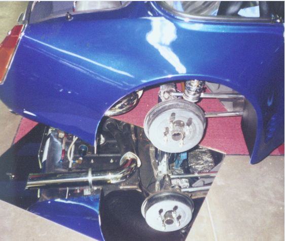

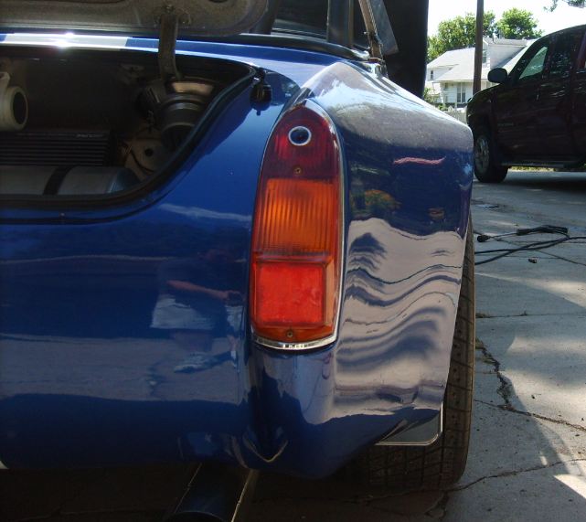

I'm running a mazda rear end and I love it
I'm using one out of a 1975 mazda truck (4.111)and did not shorted it
but I did do my flairs and got a good off set on my wheels
BROKEN AXLE NO MORE
god I hate that when happen
can't count the time's that has happen to me
How about pics. This is a new one we have not heard about using a Mazda Truck Rear End.
here one with the wheel off

heres one with the tire on
