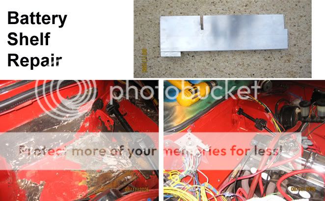

What would you guys think of welding a 1/4 inch steel perch out of tubular steel. Perhaps three pieces of tubluar steel along the sides and middle of the tray on which atop the plastic battery box could sit. The steel risers would be alongside the water channels in the steel tray. This would allow air movement to dry out water. I'm essentially doing new construction since I'm replacing the entire tray with a replacement. I was thinking that I may exagerate the forward pitch of the tray to help with water drainage.
