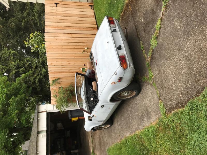

The problem was with the ballast resistor. It was bad. Such a simple thing to go bad. I am using a ballast resistor in my car because I don't have a drive resistor, and I need a ballast resistor with my coil. I've got twelve volts going in, and nine coming out, just like it says I should.
The previous owner probably did all sorts of things that he shouldn't've. Once I found out the compression was good, the distributor was top on my list. Thing was, my car originally didn't come with a distributor, but the PO put one in. I had no idea what brand he put in, so to make a long story short (too late), I replaced it all. And now my car is running a heck of a lot better. I'm going to warm it up today and set the timing, and I think it will be solid. And then that will leave me all sorts of time to figure out why my turn signals don't work. Thanks!
