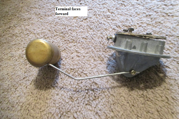

On a BJ8, at least, the wire terminal goes toward the front. That puts the float arm forward so that it can go down into the well in the bottom of the tank (that sits in the rectangular hole in the boot floor, on the forward side of the tank. That allows it to register those last few precious drops of fuel.
All that said, the last time I replaced my sending unit, I discovered that the float arm apparently was hitting the forward wall of the tank. I turned it one fastener hole counterclockwise and the fuel gauge doesn't stick anymore, but also doesn't register completely full.
The photo shows a replacement sending unit from Moss Motors that originally had that crappy plastic float that always arrived pre-cracked. I replaced the float with a Ford brass float, but the unit was still too erratic to use.
