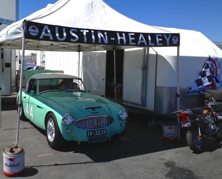

C'mon, you've got to be old enough to recognize that; it's the cap off one of those old, round-flat gas cans. You'd remove the whole cap to refill the can at a station's pump, and just loosen the small cap on top to vent when pouring the gas out, using the snorkel screwed onto the opposite side-top of the tank.Whats with the the funky cap on the brake/clutch reservoir in Randys pic ?
Probably put it on there A) because it fit, and B) to have a cap large enough to actually get a purchase on.

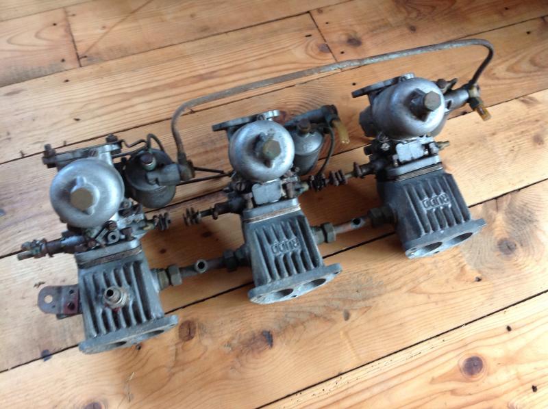

Yes the tubular manifolds are much better than the original, especially so as you have a an alloy head and hotter cam. You might get an extra 6-8 bhp. The downside, if I can call it that, is that you will experience more resonance and also lose that lovely change in exhaust sound that standard Healeys have around 2500-3000 revs.

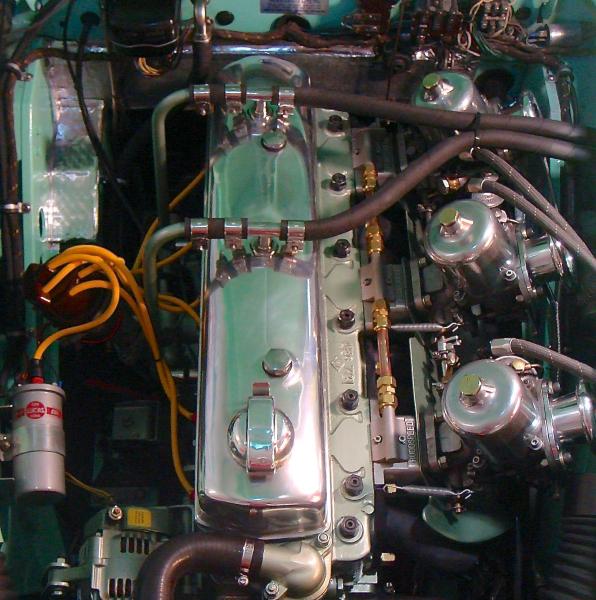

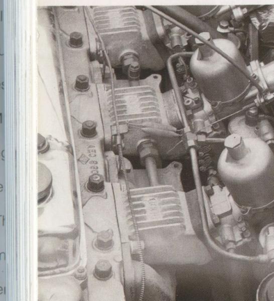

I believe those shown are the ones for the RH drive cars. There were LH and RH drive manifolds.There must have been 2 types of period casting of the Ruddspeed manifold, mine looks like Randy's example which will accomadate a hi-performance free-flowing header design. The other with the lower integral balance pipes as see here on the 1960, former Bill Bolton owned Canadian Championship winning 3000 # 171.
