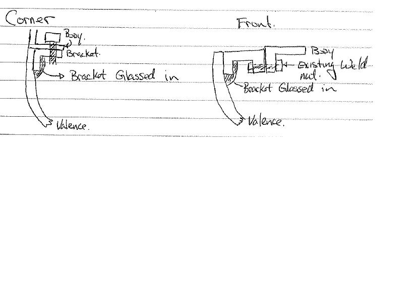

Valence mounting is my next issue. As Phantomracer said above, getting the valence on flush to the body and not set back on the existing flange requires some thought. I want to take the added step of not having any fastener heads showing like some of the alloy valences I've seen on the racing circuit this past summer (but couldn't afford).
I'm thinking of making up some brackets and glassing them onto the valence. However, the valence needs to be pulled in at each corners as the fit is poor, so there is going to be significant force pulling the brackets back away from the valence.
Can fiberglass hold these brackets on? Other suggestions? Diagram attached
