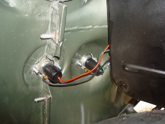

Does anyone have any pictures that they could post of the later style front lamp housing (amber turn, white park)?
Would like to see how the housing looks and how the wiring is attached to the housing. Does the ground wire attach via a bullet connector into a small rolled up metal strip on the housing, or are both wires integrated into the housing,etc..?
I posted a picture of the back of my lamps. Missing are the boots. Also note that the lamps are installed incorrectly. The housing with the green wire (turn signal) is in the wrong position, etc. This will be corrected once I determine if these are correct for my BJ8 MkIII Phase 2 model. Are these the correct housings for my model?
Thanks again!
Bob
