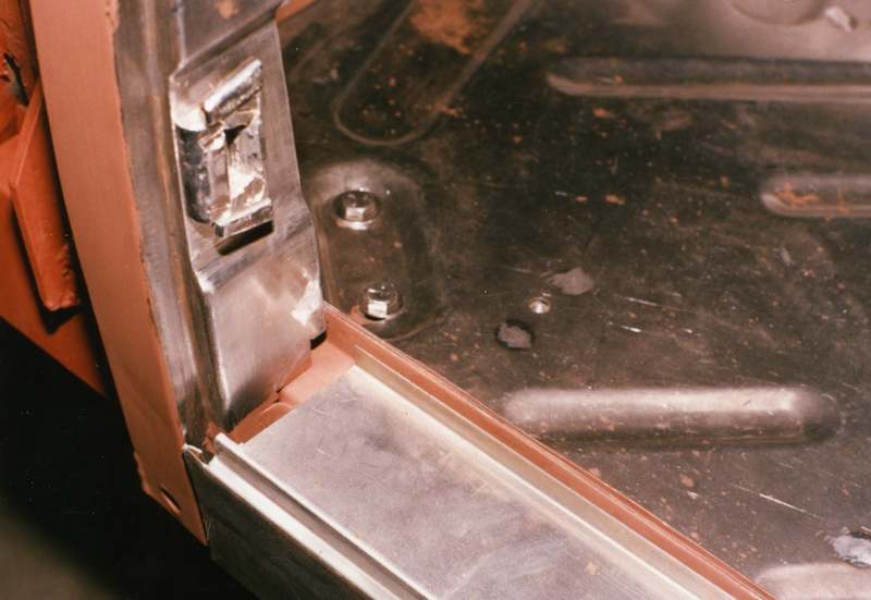

The ones I bought for my 1958 TR3A were repros. I bought them in 1988 in England and did my full body-off restoration here in Canada. The rocker panels were short by about 1/2". The clearance at the "A" post where the door swings in about an inch just below the hinges was not enough and I had to modify the new pieces. I also did another TR3A finishing in 2006 and these rocker panels (bought in USA) had the same problems. None of these have a curve to follow the curve along the bottom of the door. Here is a photo of mine when I was doing this in 1989.

The ones I bought looked like yours, but didn't have the two drain holes, the arc curve or the surface rust. When you put this into place on your TR, check it for length. I had to unfold the bend that you have where it comes close to the "B" post. Mine were too short, so I had to MIG weld a sheetmetal patch there. Clamp it into place with "C" clamps or vice grips along the top and along the bottom flanges, then mount your door using the hinges and all the flathead screws. Then carefully open the door and check the lower bottom front corner of your door to see if you have enough clearance. The repro outer sills that I got didn't have enough space and if I had left them, I would have bent the bottom front corner of the door skin out. I had to modify them - cut, patch and weld.
Good luck. I hope you won't have these problems with the ones you have obtained.
