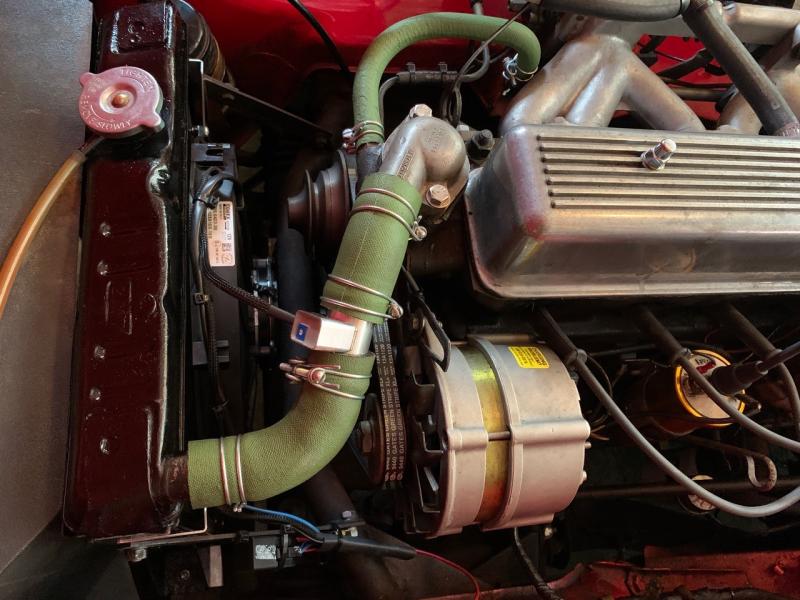

Love the Revotec electric fan conversion I just installed from Rimmer Brothers. 14" puller fan, SS no-drill (fully reversible) mounting brackets, front pulley eliminator, everything you need plus just some basic wiring skills. The fan controller mounts in-line with the top hoses, I just put it in where I was taking out the thermostatic vacuum retard unit. The fan pulls really well and the controller is very easy to adjust. About $230 with shipping from the UK, which was very fast, NFI. Probably the hardest part of the job is getting the coolant out, rad hoses off, and the fan and extension hub off the engine, for which you'll need a couple of big sockets and a little patience. After that it' a breeze though. Should have done this a long time ago.
