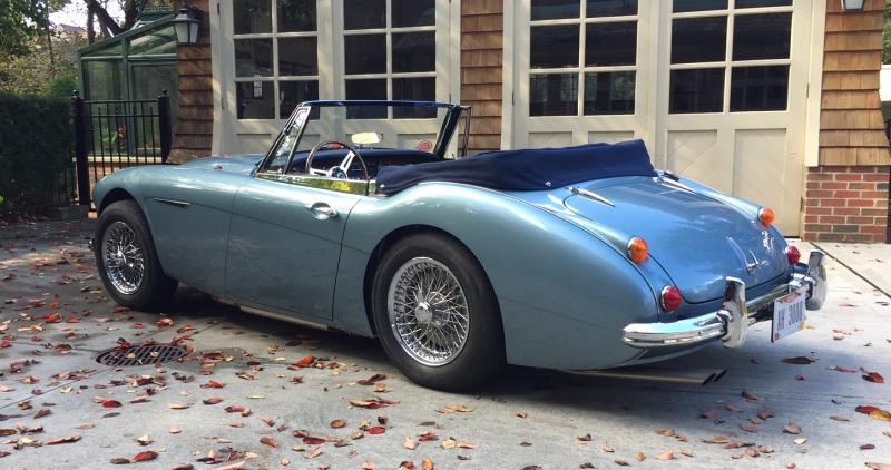

My restorer uses standard Moss springs and has them recontoured to his specification. It may not be how BJ8's are "supposed" to look, but it is the way God, Donald Healey, and Gerry Coker intended!
That does look mo' betta, and since you don't have resonators you won't trash them every couple of years. It's a shame BMC couldn't be bothered to modify the rear wings on the PII BJ8s.
It may not be how BJ8's are "supposed" to look, but it is the way God, Donald Healey, and Gerry Coker intended!​
I totally agree ... and with smaller tail lights you would capture even more of the traditional Healey look as did the BJ8 Phase 1 and BJ7.
