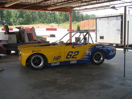

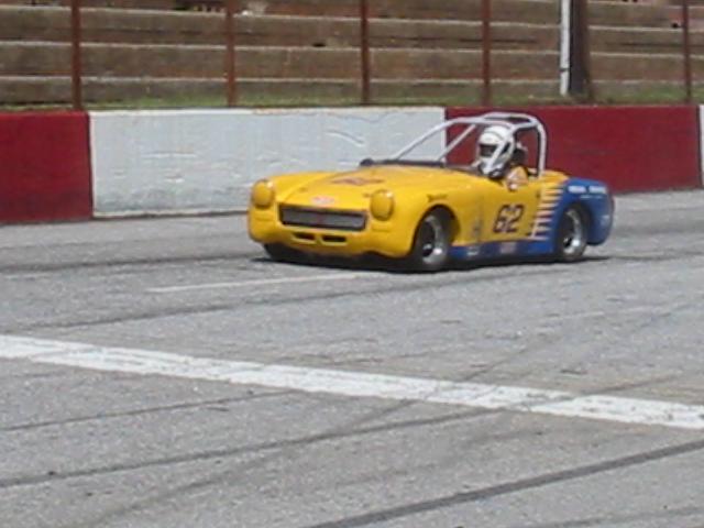

You can still get them, but they are real expensive, normally special order, expect to pay as much as $300 or so a wheel. Superlite has a GTR racing version which are $170.00 each, I'm a Superlite dealer, on my site listed below you can see a picture on the wheels page of the 13x5.5" GTR race wheel, it lighter than the street version. Of course it's same ole minilite looking wheel in a race weight version, but the price on them for a race weight wheel is hard to beat. I can also tell you form experiance with wheel and the Spridgetech body work, you'll need to run about 1" wheel spacer to get near allowed track (SCCA), the Spridgetech bodywork is nice, but it sticks out alot further than Huffaker, Prodbodies (formally Japco) or the rest. Here's a picture of a car I built with the Spridgetech bodywork and 13x5.5 Revolution, with a 3.5" backspace running .750" wheel spacers and as you can see the wheels are still tucked in the bodywork more than I like, and those are 8" wide cantilever slicks.

I'll add this, after using many body kit, I really like the Spridgetech body, however if I could change anything about it (and I would make changes to all the other offerings as well) it would be to have smaller wheel openings (they are huge) and for the flares to stick out a little less.
Flares do stick out a bit more than I like to even with six inch wheels and 3" bs there still tucked quite a bit.
