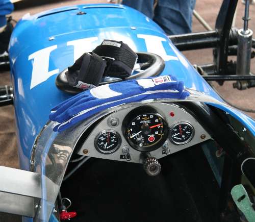

Way back in March he sent me the old AutoMeter tach removed from his car. I installed it in the instrument panel of my father-in-law's vintage Linx-B Formula-Vee. The car had many changes for its last outing in late April and the shift-light on the tach surely helped us to achieve better lap times.
Two pictures of the tach and the car can be seen at:
https://home.mindspring.com/~dklawson/minipics/AutoMeter_Tach02.jpg
https://home.mindspring.com/~dklawson/minipics/FV-02.jpg
(Sorry, I don't know how to directly post pictures so cut and paste the text if the hyperlinks are dead).
A little black shoe polish on the horn and collar, add
a new wheelskin leather wrap and ...bingo.
Here's the old Autometer in the V. Looks great!
Glad it found a good fitting home.
