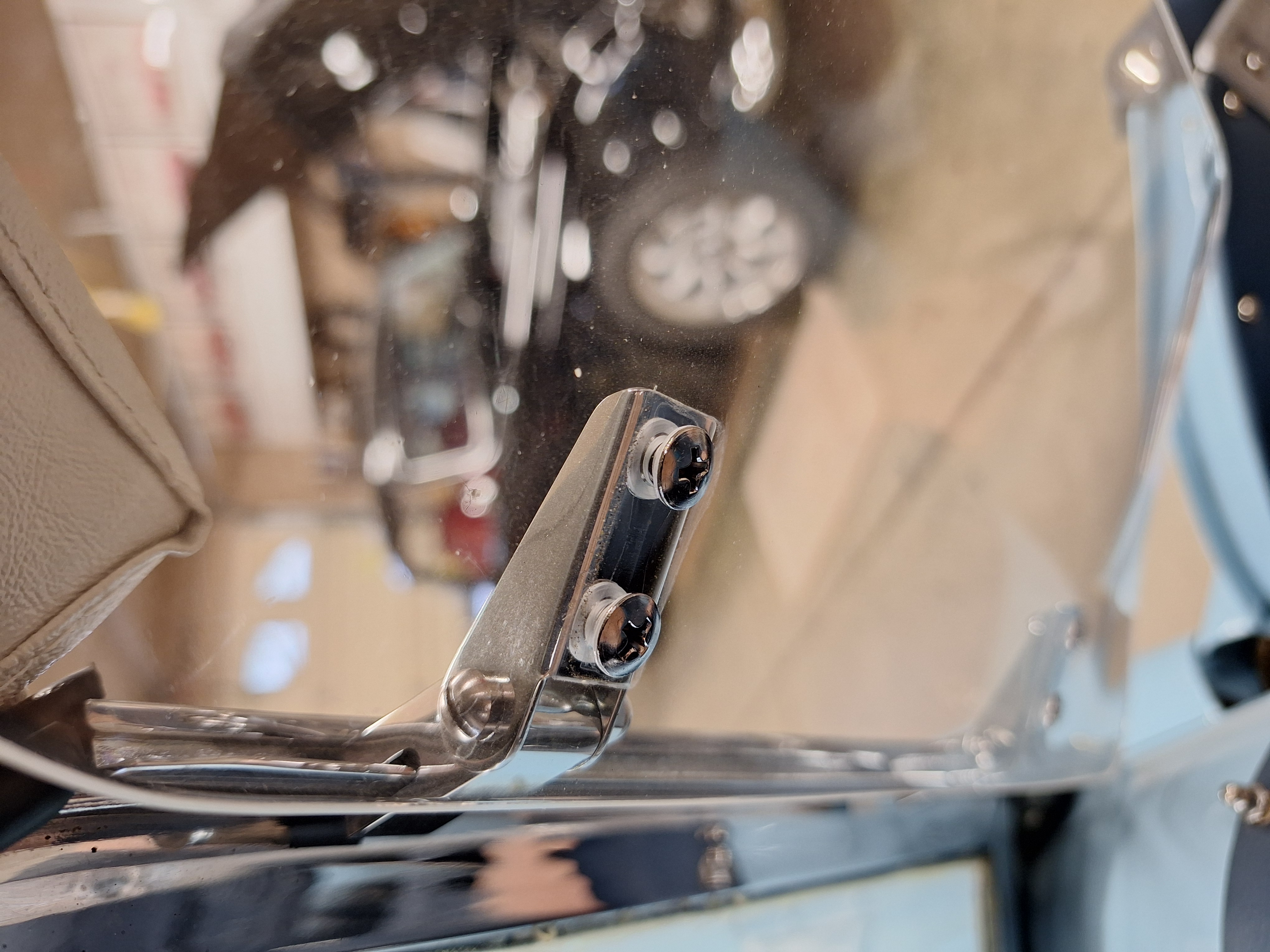

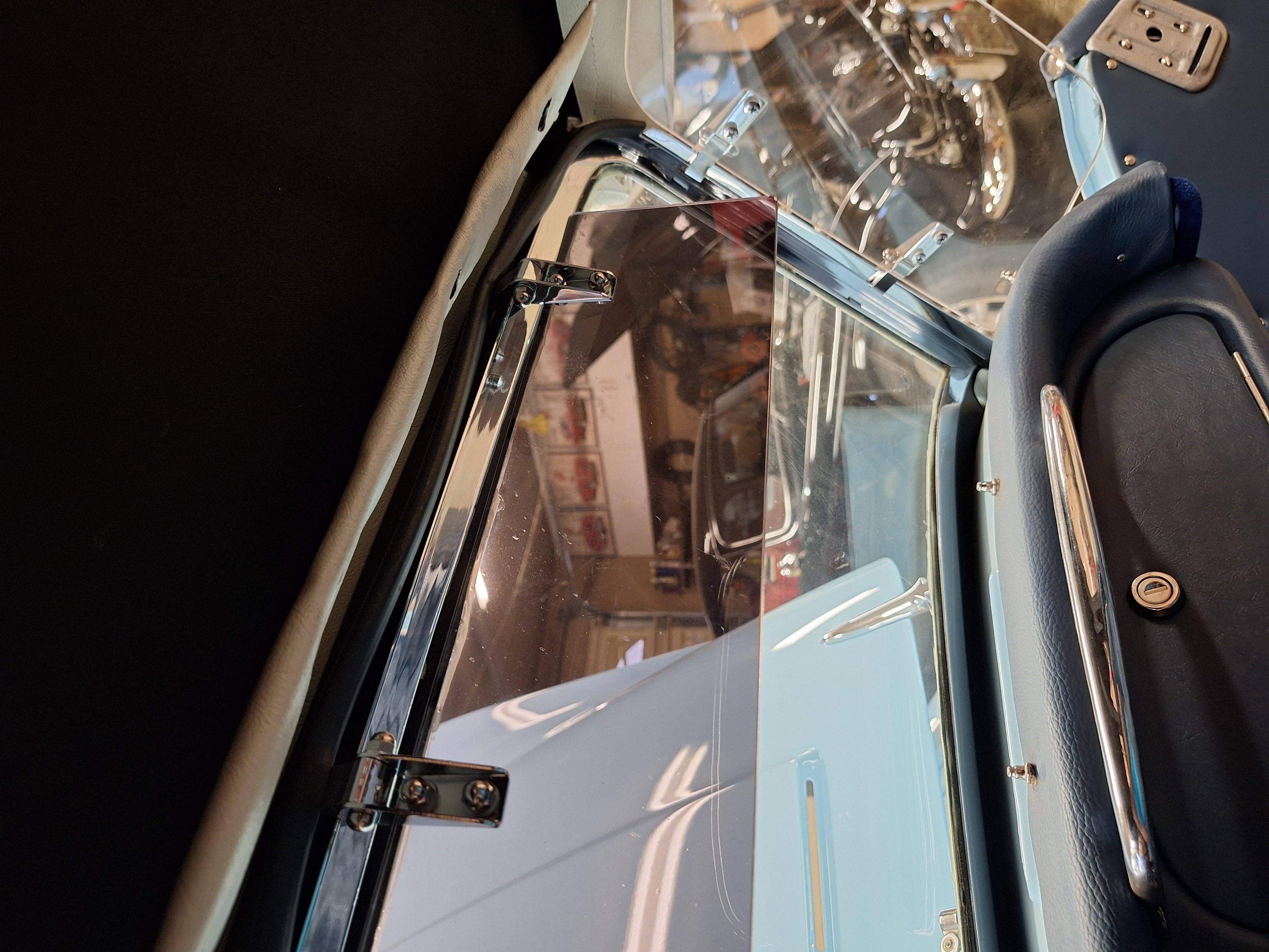

I use the smoke colored plexiglass visors in my TR3. Pics attached. They use the same attachment as is used on the side wind deflectors.
Charley

My 59 TR3A came with one smoke plexi visor on the driver side. I ordered a matching on for the passenger side. They mount with allen-head set screws that clamp on the window frame. Easy install.
Many Thanks Helmet. I have successfully installed the sun visor. The issue was that Rimmer/Moss don't show how the visor is attached, and the same with their eBay adverts. I spoke to a classic car engineer and he was suggesting drilling the windscreen frame which I was never going to do. The grub-screw fixing is perfect for the job. I just wish the parts vendors would add that touch of detail rather than have customers have to guess.
