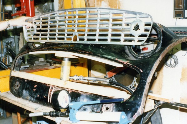

Before you knock yourself out restoring an old grille you might want to confirm that it is an original grille or at least a recent repro. For a great many years the repros had smaller openings than the originals. Apart from possibly restricting airflow, they just didn't look right.
Here are the 2 grilles I refer to, bottom one is the original:
You used to see a lot of TR3As where the grille was curved in at the middle about half way up. There were so many about 10 to 20 years ago like this that everyone thought that this was the way the grilles were supposed to be when they originally left the factory and this curve almost got written into different judging guidelines as being the correct way. My grille got mangled along with the front apron when I hit a fence post in a rally in the middle of the night in 1963. The grille never fit properly after that.
When I was doing my restoration in 1987 to 1990, I used a small hydraulic jack and some wood to force the "mouth" open more till the brand new grille fitted correctly.
If you do have one of the repro grilles with the small openings, it is possible to enlarge them, by carefully pinching the rear edges closer together. The aluminum is really soft, though, so be careful not to go too far.
I've also had the problem Don mentions, although I got the grille to fit pretty good by bending it inwards in the middle. As noted, it looks like it is supposed to be that way (although it isn't).
