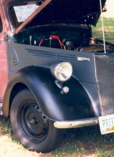

Right, epoxy is the only way to go if you want to prime then delay the final paint for a while. Actually, I prefer it in all cases except where I can't properly metal-prep the surface first. Then I would use a self-etching primer. Even then, if it will be a while before painting, I would use am epoxy sealer over it.
I don't know that it can actually be polished but it is considerably glossier than lacquer primer. The attachment is a crop of my Prefect front wing. It and the wheel are PPG DP90, black epoxy primer. The valance and headlight are DP40, gray/green. Both are untouched, as they came out of the gun. Sadly, the car has not been touched for 8 years but the paint still looks exactly the same. Man if I can just get that shop built this spring.
