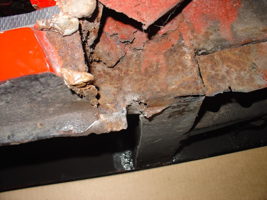

On the way I found this novel three part sill construction...
and most of the front valance mounting points not physically connected...

Looks like the infamous "tin worm" has done in your inner and outer sills and parts of the lower wings. At least you can get good replacement sheet metal bits from AH Spares as believe they make good stuff. Good luck on your restoration and agree with you keeping it the original color - I'm kinda partial to red cars too. Keep posting pictures of your progress.

Steve, you call that rust? Seriously, you have a great starting point. Even the flanges on your shrouds look perfect. Keep us posted on this great project!

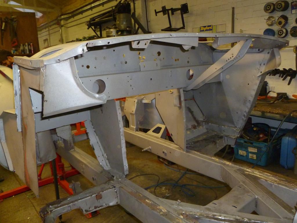

Things are moving along a little. Just got back from JME where they have had my inner bodyshell sand blasted to see just how bad she really was. Apart from some of the crude repairs (Three layers of patches in some places, lots of pop rivets and braised joints) only one extra job popped up. The central cross member had rotted from the bottom so needs adding to the list. Outer panels are being soda blasted and are due back in a few days. Luckily everything was straight. I know from some of the paperwork I have the car was involved in some sort of accident in the 70s/80s but it hasn't bent anything. Car aligns on their jig OK.

Got the tub back from JME today. Now just got to work out how it all goes back together.
Hoping I haven't bitten off more than I can chew. Feeling a bit daunted. Don't really know where to start!

Hi Steve, try to imagine you are involved in the assembly in the factory. First install the brake piping and wiring. Then focus on the running gear, suspension & brakes. In the factory the power train was installed almost last but most people now do this before fitting the outer panels. Finally fit the trim. Sounds easy, eh?
Hey Steve,
Body tub looks beautiful ! I use carpet tiles in my garage also- kinda handy when the old gal leaks a bit and finally ruins one of the tiles - just pull it up and replace. Good luck and try not to get overwhelmed as I did on an MG TC years ago that took me 20 years to complete !!!!
Regards
Mike
This is the order that Four in Tune is executing on My car. Access is easier with the outer panels off the car and apparently the panel fitting is better with the weight of the engine/drivetrain in the car.

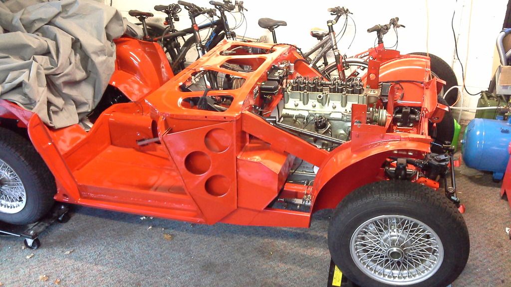

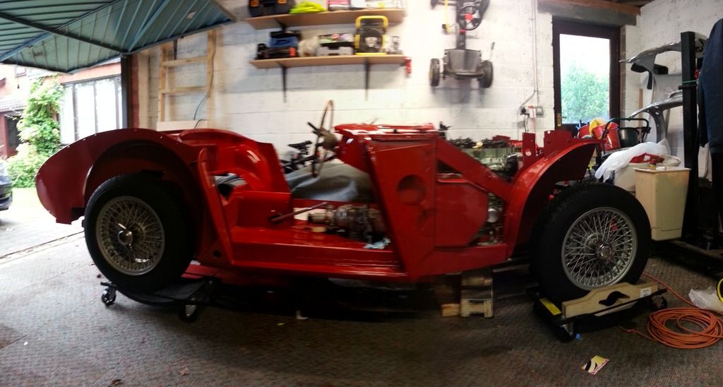

Despite the best intentions my plans to update this thread on regular occasions came to naught.
So below is some of the very slow progress I have been making over the last couple of years (funny how there's always somthing more important to do....)
First is a general view (and slightly out of focus and taken as a panarama on my phone hence the distorted perspective)

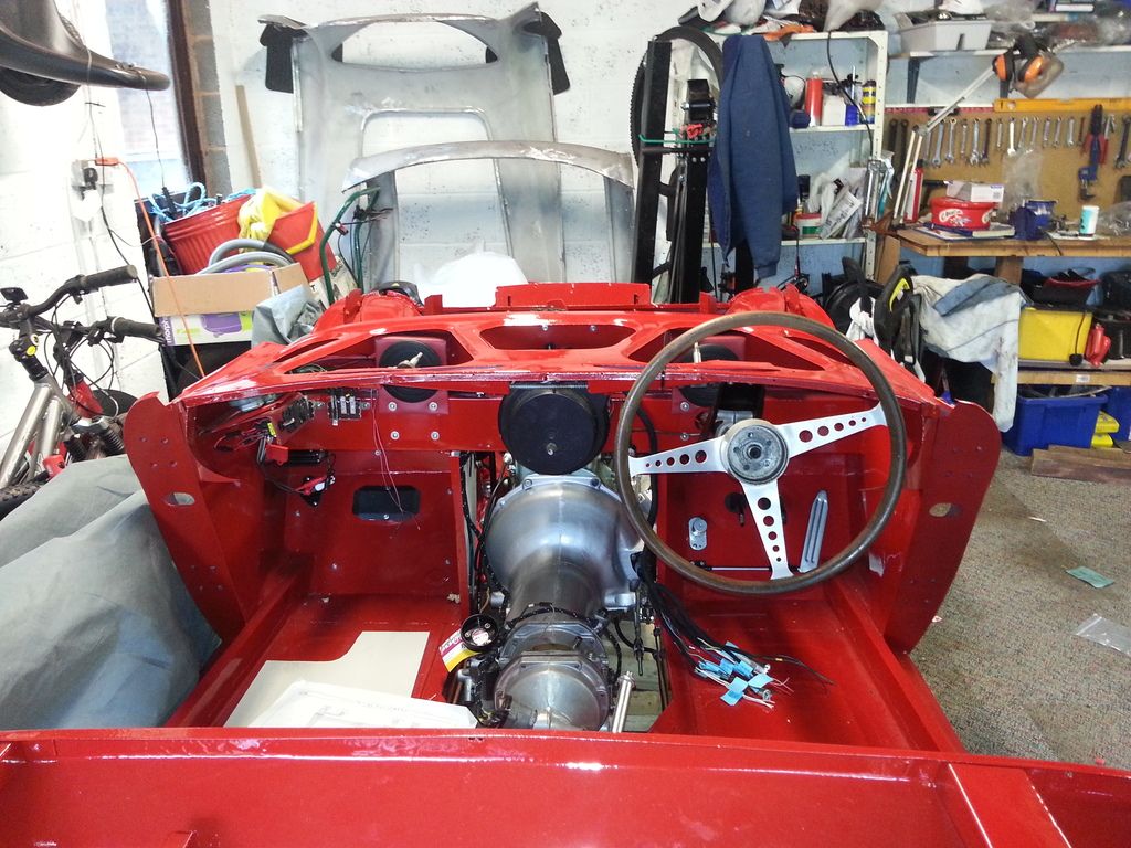

Second is the cockpit looking forward. Still with original (broken) steering wheel and steering column. Plan is to get the steering column reconditioned and made collapsible. JME are working on a design that allows it to be collapsible while still using the original trafficator.

Below is another general view

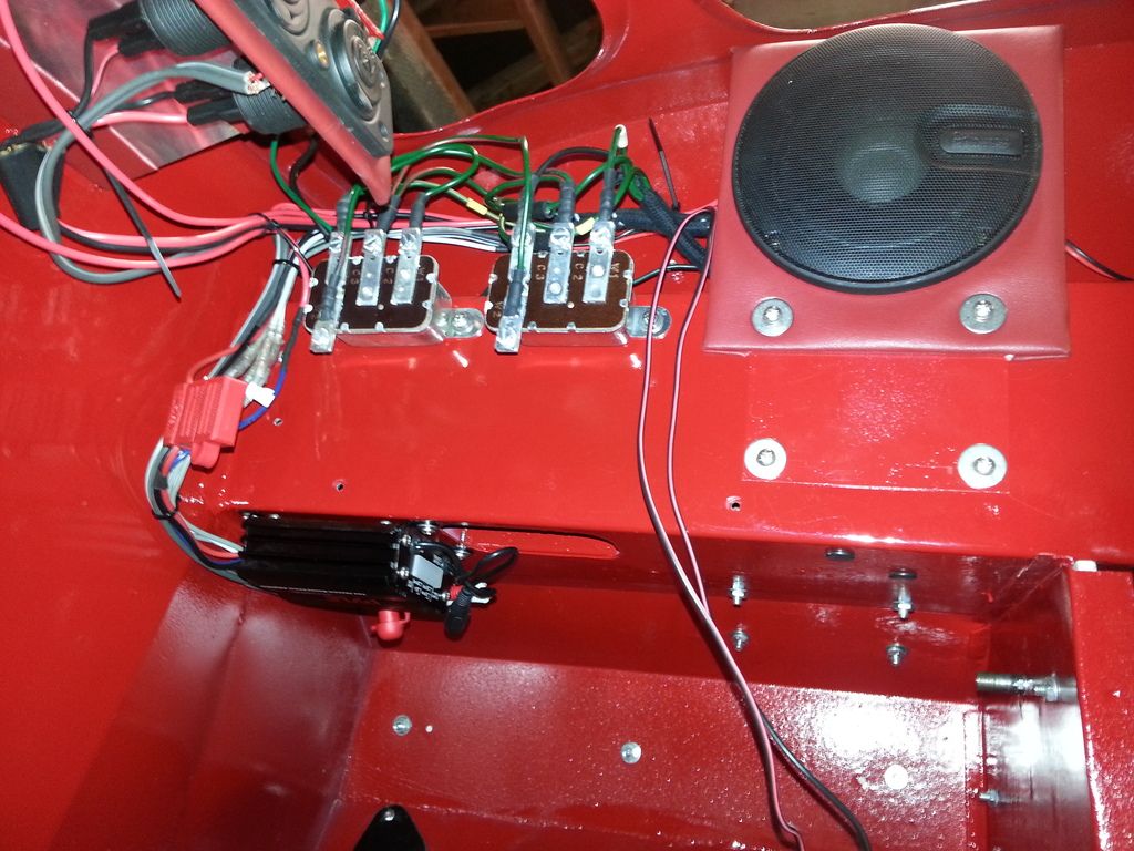

Last is my music mod. I can't drive without music! The whole thing will be driven by my ipod which plugs into the panel you can just see top left. This also has a pair of USB sockets to power the ipod and a cigarette socket for my SatNav if I need it. The amp is visible hanging from the top of the footwell. The speaker brackets and control panel hosing use existing holes. I only had to drill four small holes for the amp and the whole setup will be out of sight. Still need to tidy the wiring a little though.

Steve, it looks like you have made a lot of progress in the intervening time period. My car, built a few months before yours sat forever. Eventually I realized that I did not have the skill set to undertake what you are doing.
Steve, looking very nice. One thought - doesn't the JME collapsible column need some welding to the bulkhead. I was looking at this option but as every-thing has just been painted I am trying to find another option.
