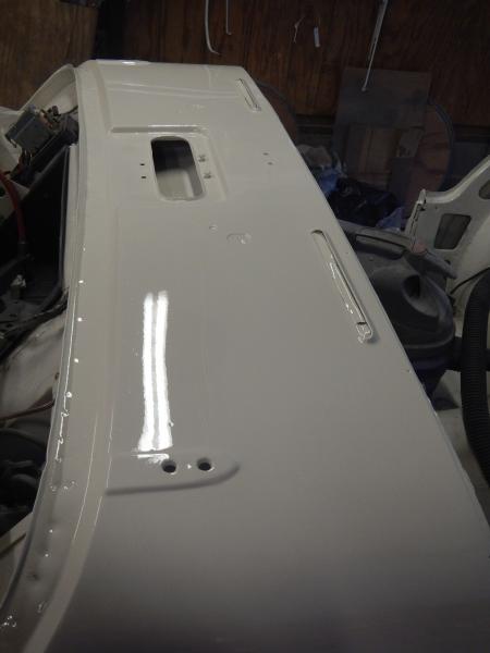

I went over the scuttle and boot lid with 320, 400, then 600 and got a really nice finish. I did not have orange peel but I did have slight undulations in the paint I think they call it Fisheye. I still have a bit if you zoom in on this shot. I hope it will polish out.

For this stage I use a red glazing putty that comes in a yellow tube which is sold at most paint suppliers. You go around your work and fill any pinholes, bug divots, or other tiny imperfections. Then re-wet-sand using blocks until the surface is...once again...perfect. I use 400 grit for this. Many use 600, but I am too impatient. There will be small red dots where the glaze filled in the deeper imperfections. The orange peel gets sanded level.
Note: this glaze is a laquer based putty. It must dry overnight before sanding.
I must have missed the glazing putty somewhere along the way. How would that do with white? Presume there is so little left that it will not show.
Back to the paint store. Probable need a return trip anyway as I think I may run out of hardener. I had extra paint mixed up so they may have been off in the hardener ratio. I have been very careful to use exactly the correct amount.
