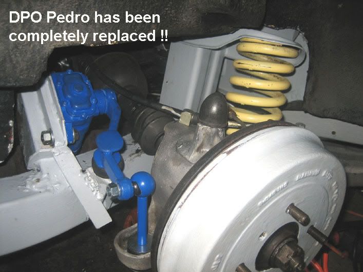

Here's a photo of my NEW passenger rear. I belive it is
sound, safe and installed according to Bentley standards.

A couple of observations(queries) Those welds for the shock mount and stopper look like someone abused the factory welds. Does the other side look like that also? If so, maybe just my imagination, If not I recommend you take it to someone who does good welding who can redo the bracket and stop properly.
Also, I didn't see any collar on top of the spring. Believe there should be a rubber or hard nylong spacer on top of your spring. Did you replace the spring with non stock springs. Did the spring mfr. recommend doing away with the spacers?

Yup, one of yer eyes is pretty good. The Crypt Car
was wrecked some time in it's past and the weld
buggered up along with buggering up the trailing arm
that caused the wheel to seperate from the car while
driving. The Crypt Car is not streetable and on jacks.
That crummy looking weld will have to remain.
Yer other eye needs attention concerning the coil spring.
Both mounting rings are present. You can see the black piece
at the upper right of the coil spring in the photo. But you
did in fact get me to pull the wheel off and check on it
myself. LOL!!!
