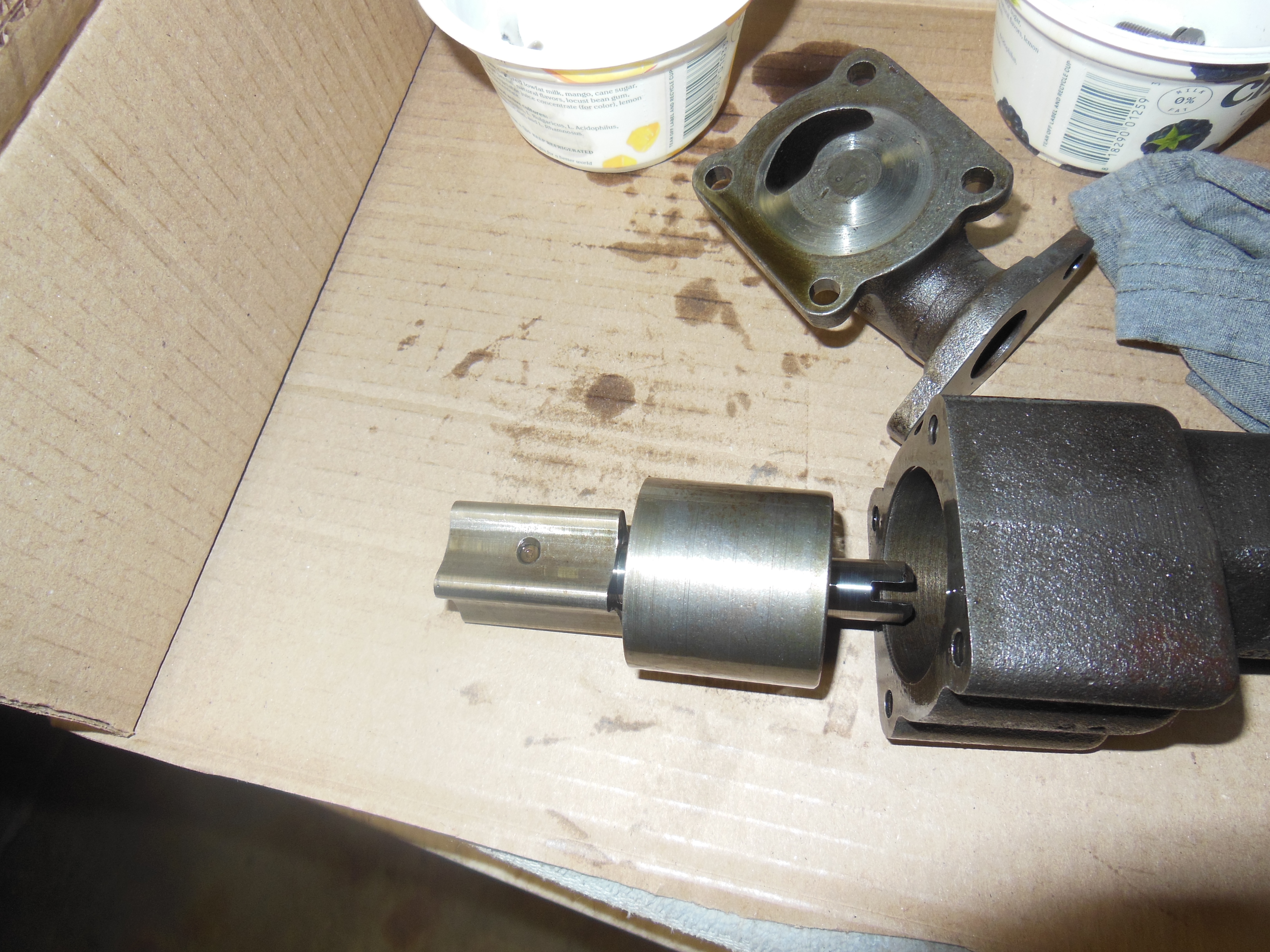

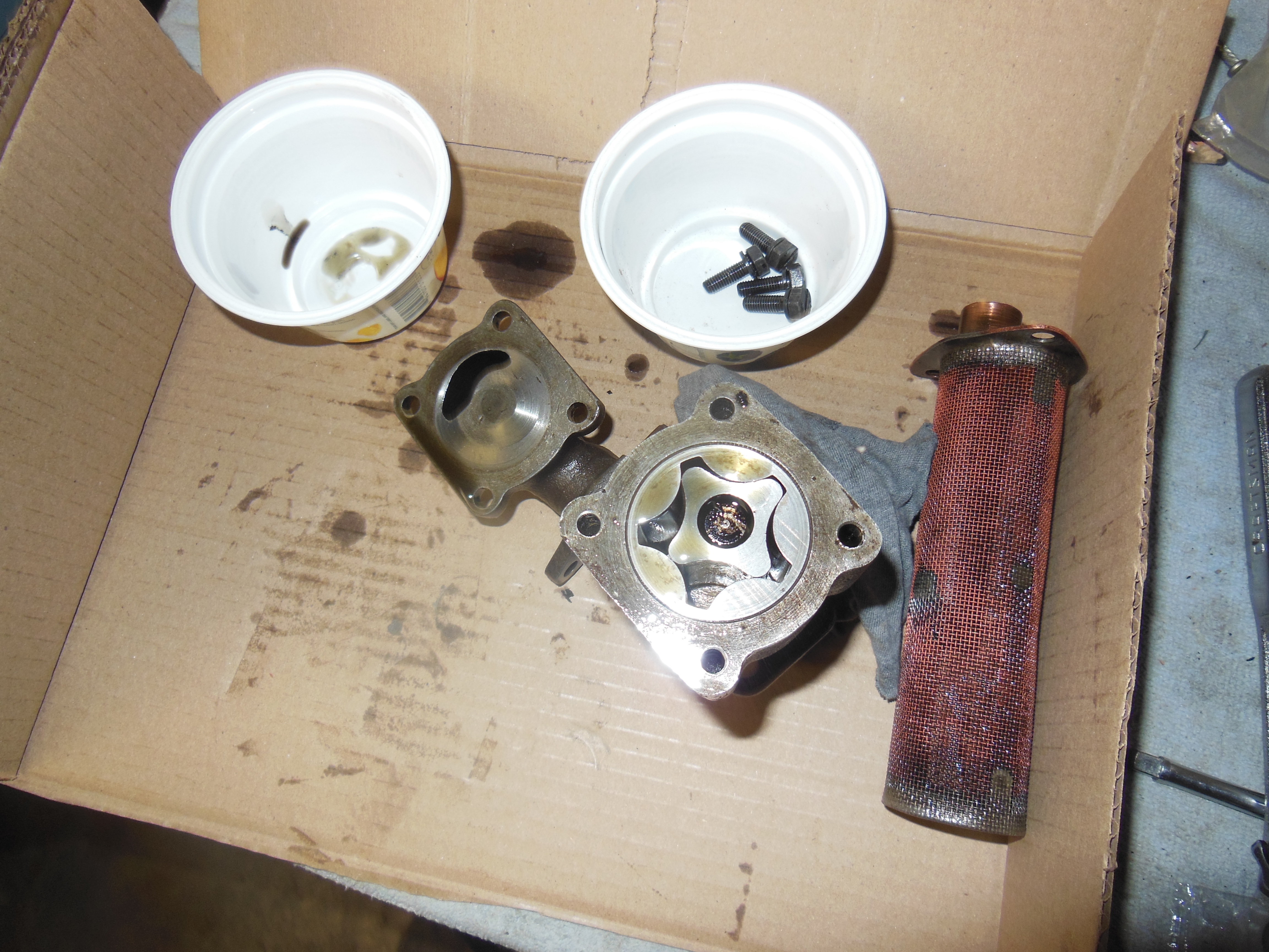

The metal shavings mostly were in the bottom of the pan and in the oil filter canister. I have not looked in the peruse regulator yet. The shaving stuff looks different from the oil by its color. I can see the difference kinda clearly I think. I took the oil pump off and the oil pump looked fine inside and the oil around everything in the pump looked like clean oil. There was some of the shaving colored oil on the outside of the screen on the fixing end, and actually not much or any metal chunks on the oil screen. The stuff on the screen is mostly the red goop gasket sealer I used. I will get off the oil pressure deal soon and take it apart and clean it.

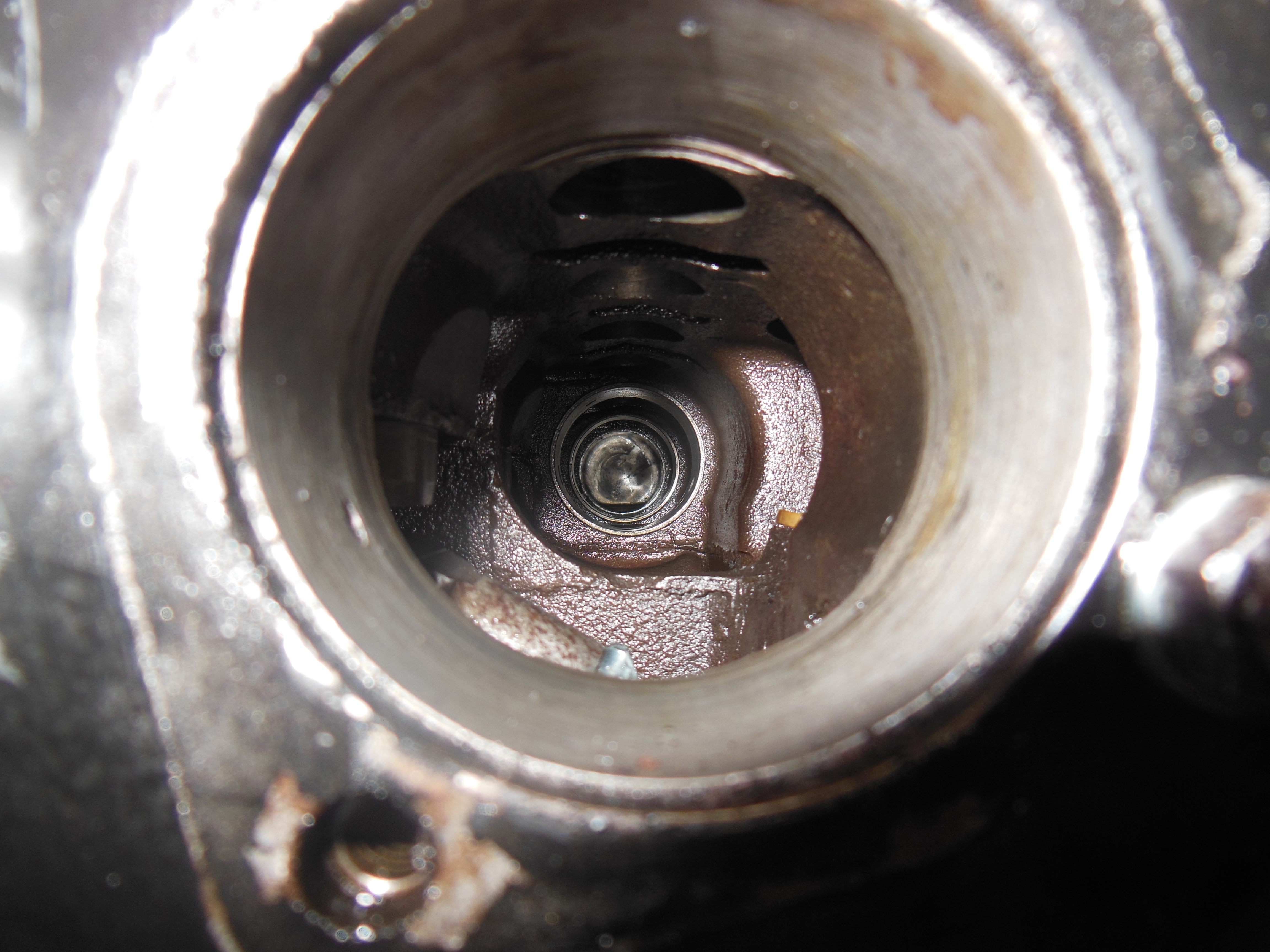

The cam bearings look like they should work out fine. They appear to be plenty thick enough without a bunch of deep scaring. I plan to order gaskets and other parts now that I feel better about the size of the pistons.
