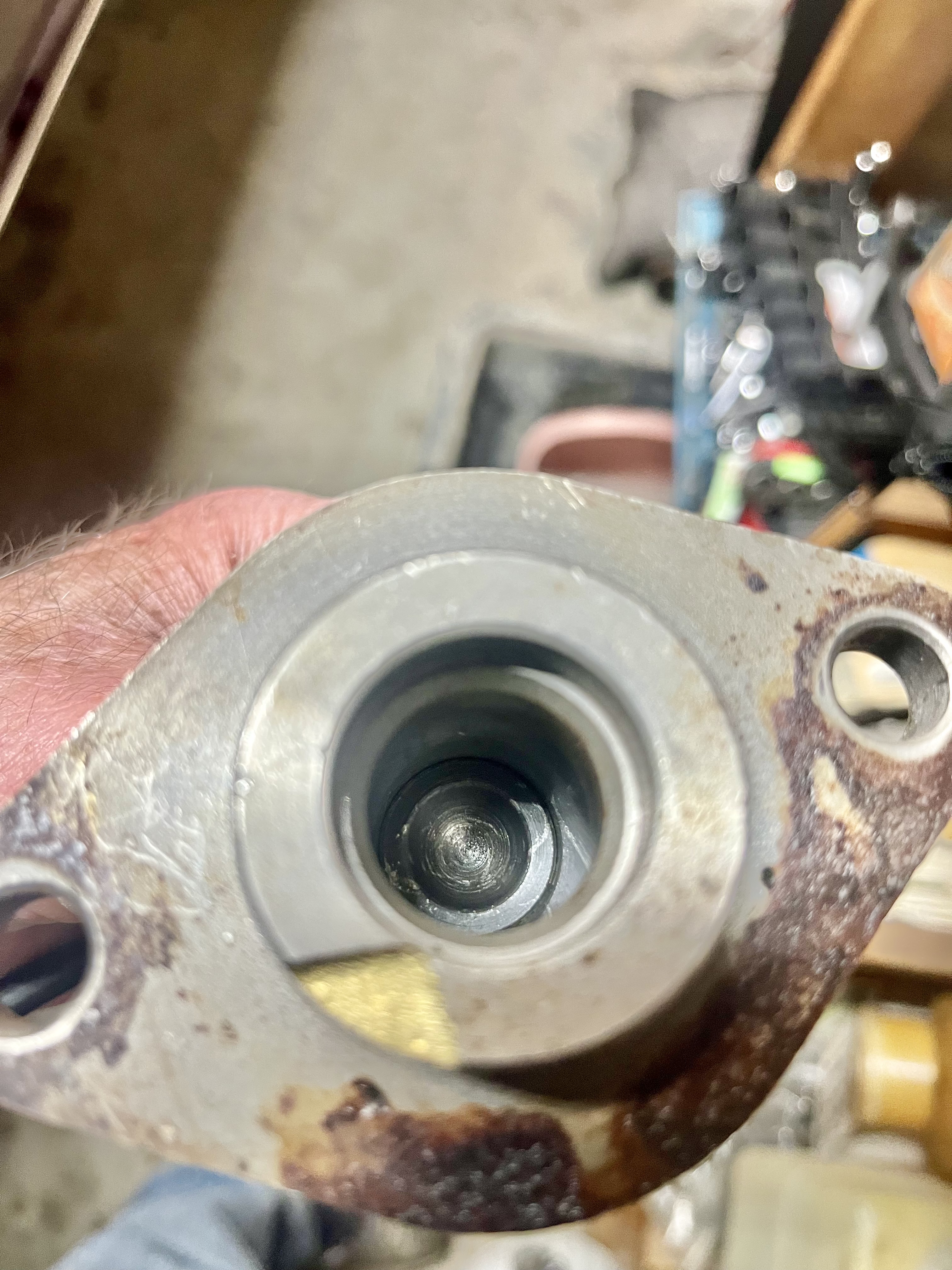

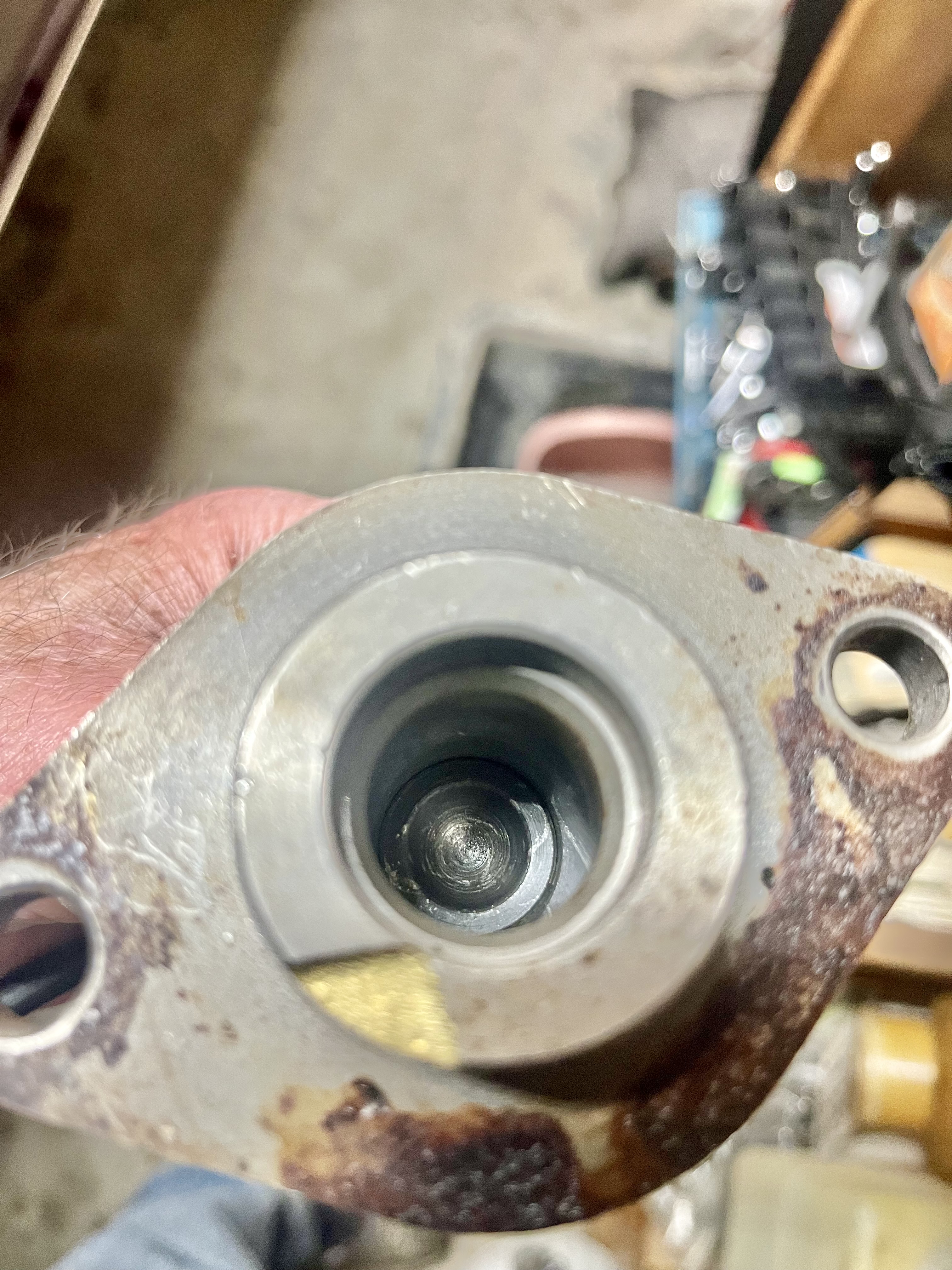

OK, I found the culprit. I removed the master and found that the piston on the master is pushed in and It did NOT return. I just ordered a replacement master cylinder. It pisses me off that a simple fluid change resulted in getting a new master.
Do you know the brand of the old one ?
Yes, it is the Lucas one. I've tried tapping with a wooden hammer to get the piston to move back to the front of the bore but no luck.
All of the normal vendors do not have the Lucas (made by TRW) in stock so I had no choice but to get the less expensive one.... I hope it will do the job. I would like to rebuild the one I have but I can't see how I'm going to move the piston back. At this point I must get the car done and back on the ground in the next week or so. Hopefully I'll have the new master by Saturday and I'll get it installed and bled but this time I intend to use a vacuum pump.
The tipping valve might be whats holding the piston stuck
I intend to investigate that after I get the replacement in and working. If I wasn’t under a timeframe to get it done I would do that now. Thanks again for your timely and informative posts.
Here’s a pic of the master cylinder that failed.
The piston is down about 2 inches.
The retaining collar holding tipping valve in is going to be hard to remove.
