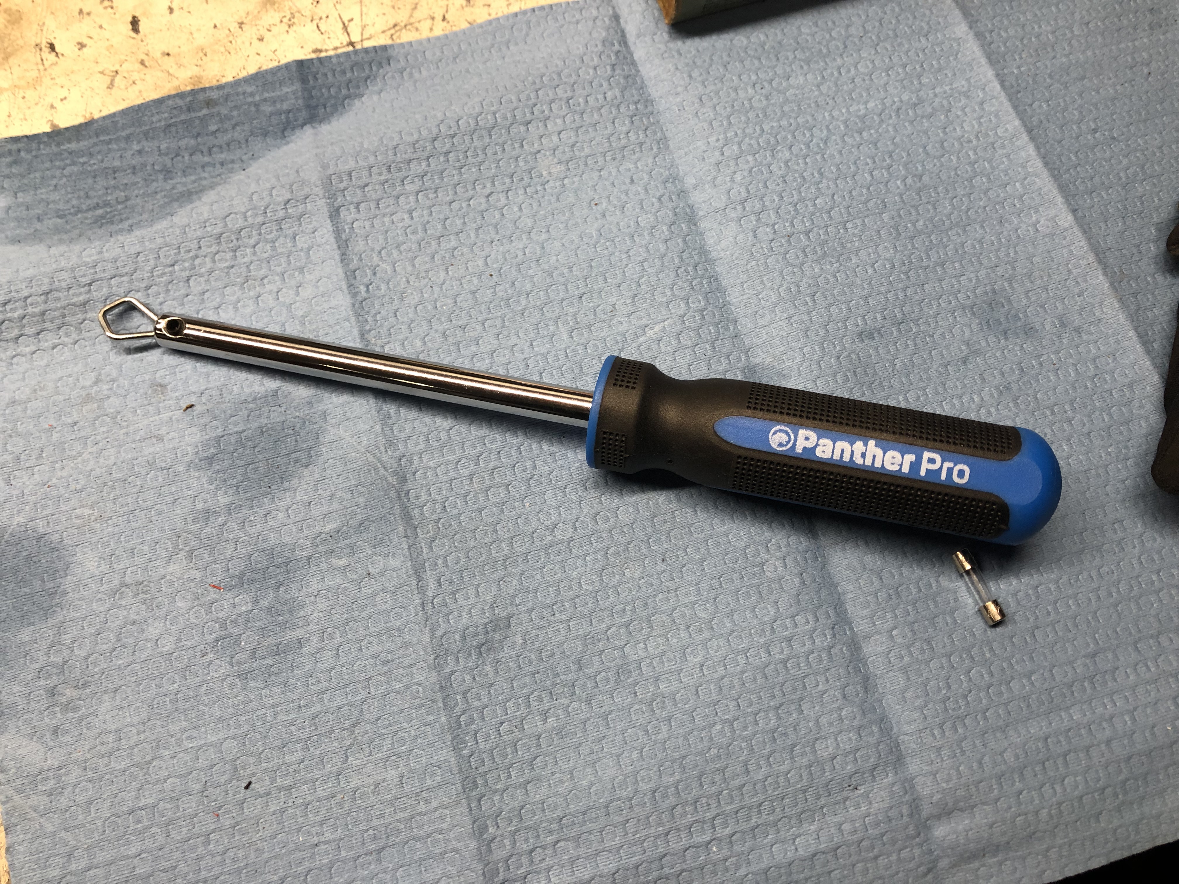

Eventually planning on tackling the old seals on our BN7 window. Never done it before and just starting to wrap my head around how to do it. Can anyone share a pic of the trim tool and spline installation tool? Where can I purchase them (located in Ontario, Canada). Thanks.
As I recall we made them as we went from small nylon spatulas and chopsticks. Plan to use lots of Windex and have lots patience.
There is no “special trim tool” that I know of. I have a hard flat plastic trim tool, but can’t remember where it came from.
You do need the spline installation tool; see pic - this is one from Cape International.
