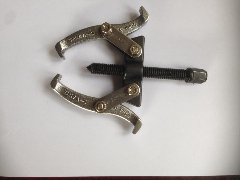

Hi Derek
one photo of your puller is agreeed by me (just to buy the right one)

Here is a photo of the puller I used. As I mentioned it did not fit perfectly and it often slipped off the arm due to it being at an angle to avoid the lower suspension A arm. Eventually after a lot of effort I got it stable and was able to make some small turns on the tightening nut. It doesn't take much before the arm will suddenly release.

I do not think you will be able to use the three legs. There is not enough space, plus the steering arm only has two 'shoulders' on which you can get a grip.
