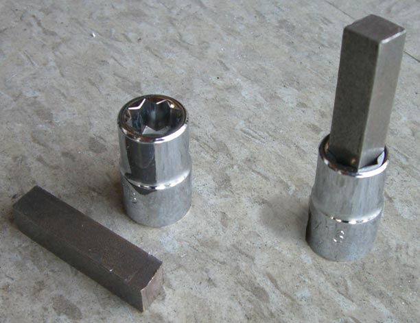

You guys got me thinking. I really didnt notice a leak until after I replaced the oil in the diff a few months ago. It could be the drain plug. I didnt have the correct tool for that square plug. So I improvised. Any idea where I can get that correct tool? cheers, Zane
Sounds like you need a smoke wrench.
Another option would be cutting a piece of 7/16" square bar and putting it in a 7/16" 8 point socket. This one is for a 1/2" ratchet.

If I recall, 'tis.
If you have the ability......find a piece of 7/16" square stock about, oh, 12-14" long.
Clamp about 1.5 to 2" in a vise, heat it cherry red with an oxy-acetylene torch, BEND the long part to 90 degrees, let it cool, de-burr the edges, and you now have a tool you can keep in your toolkit.
You can also use a 19 mm 12 point socket to remove a 1/2" square fill plug--I just did it today when I changed my diff oil.
