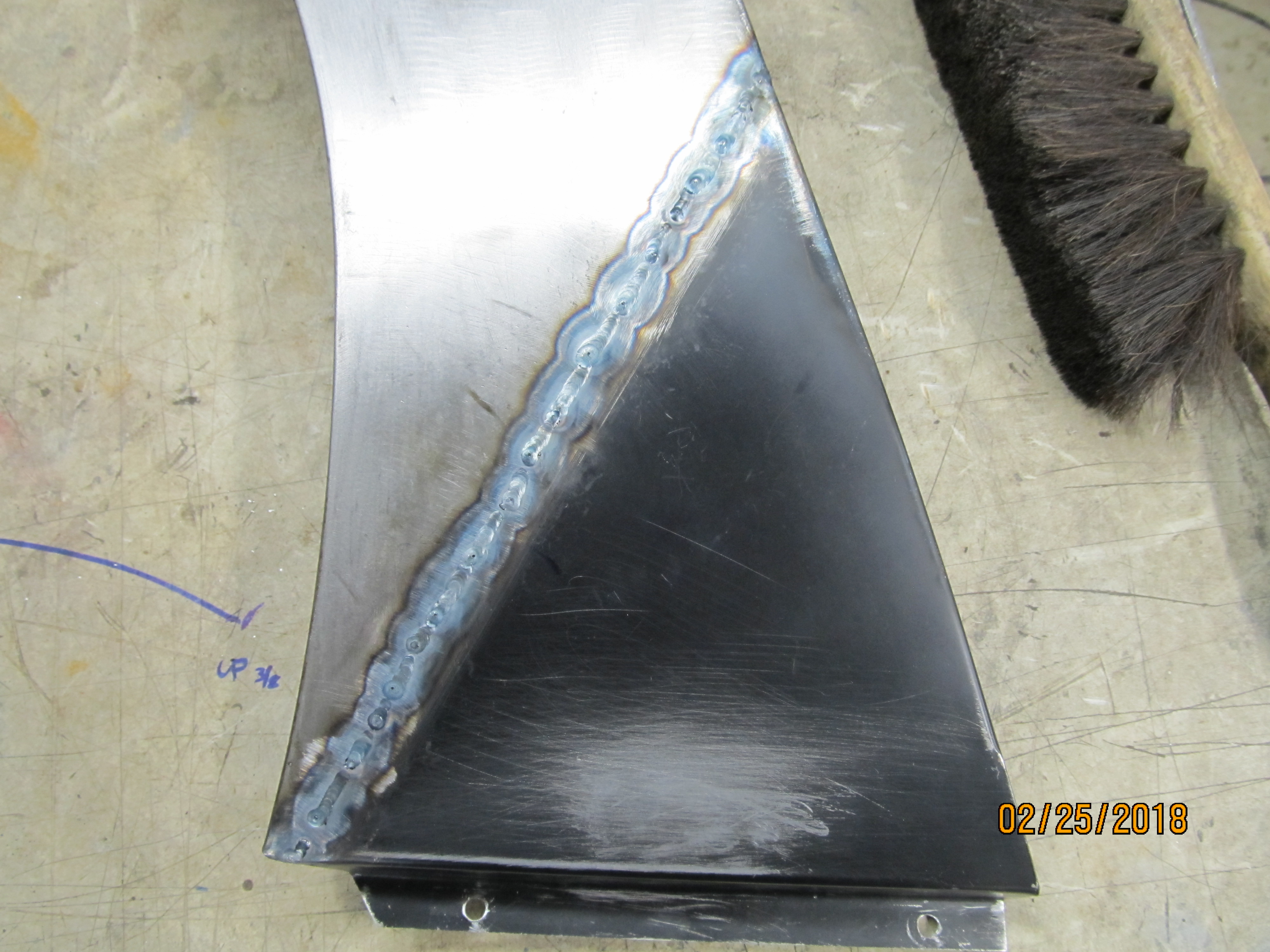

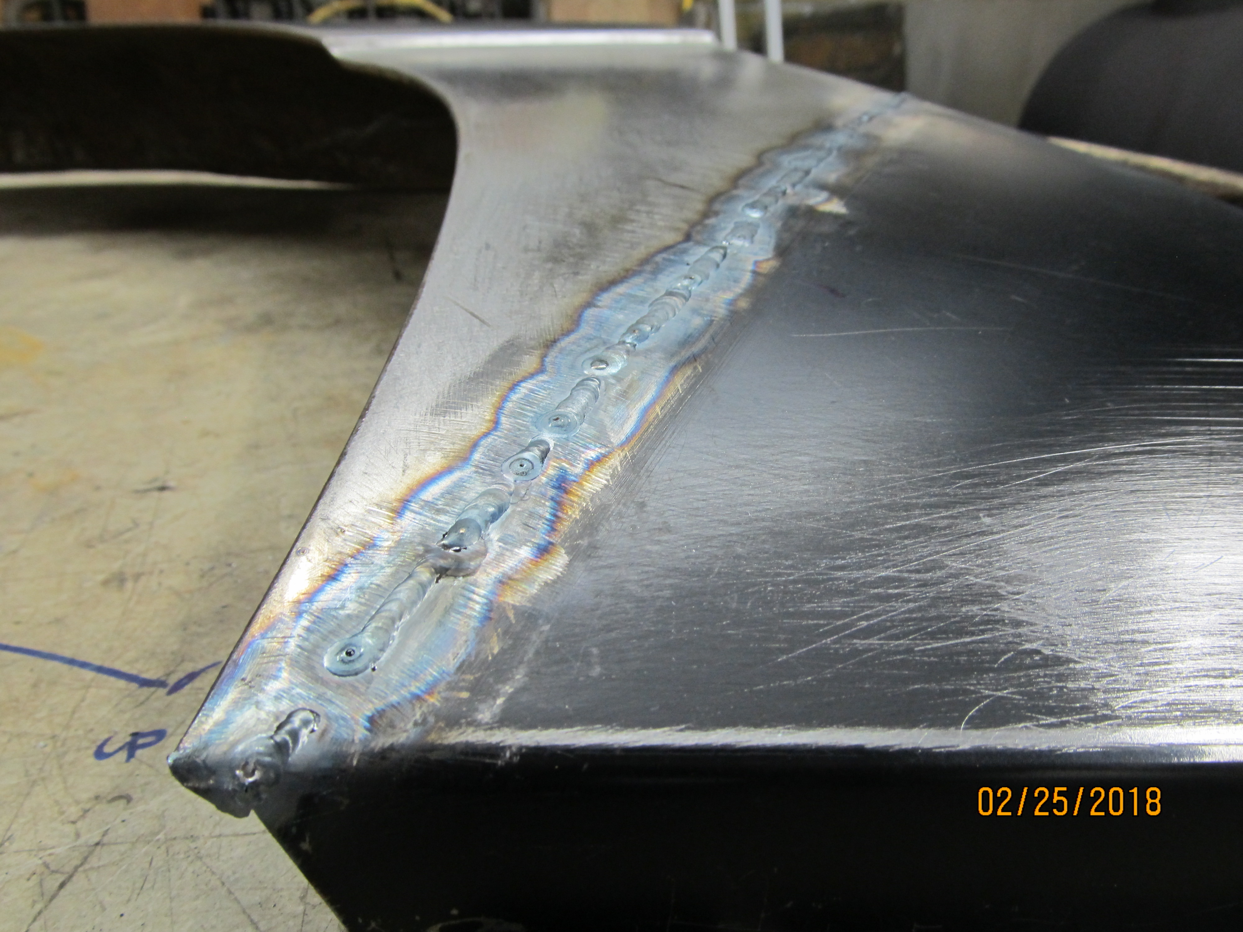

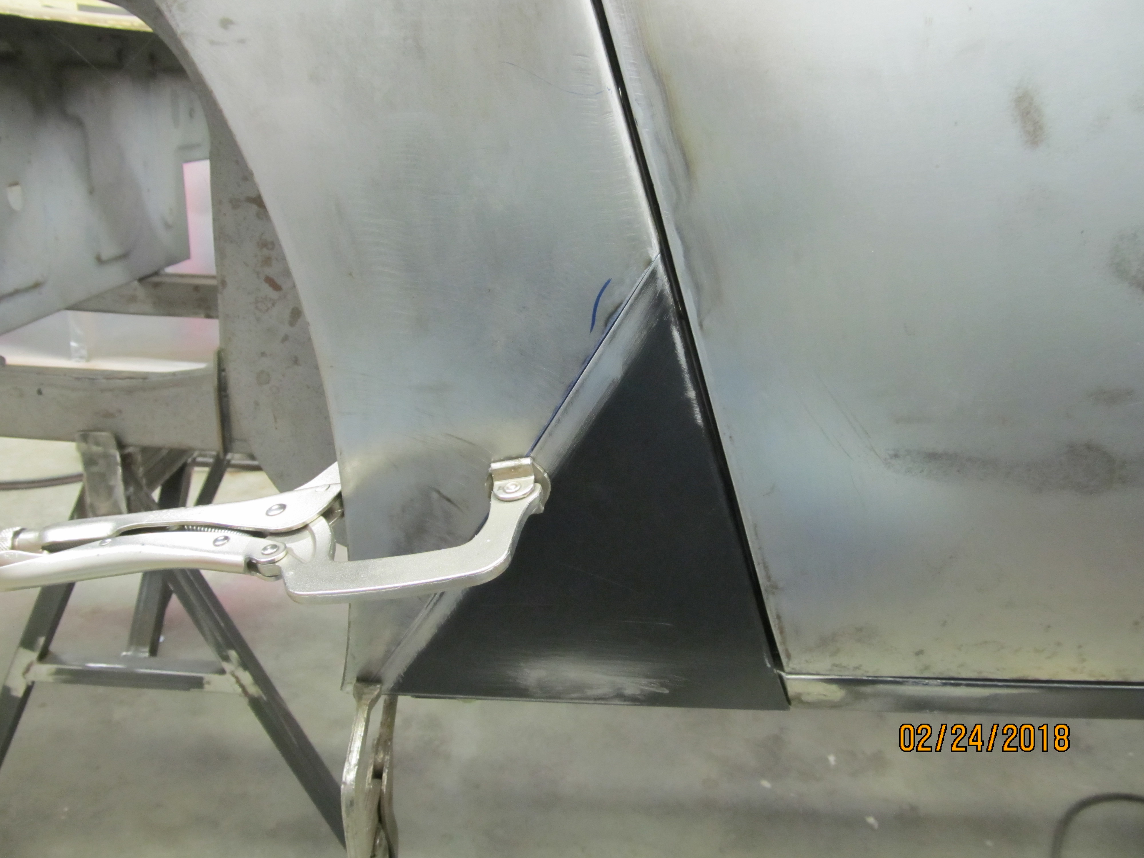

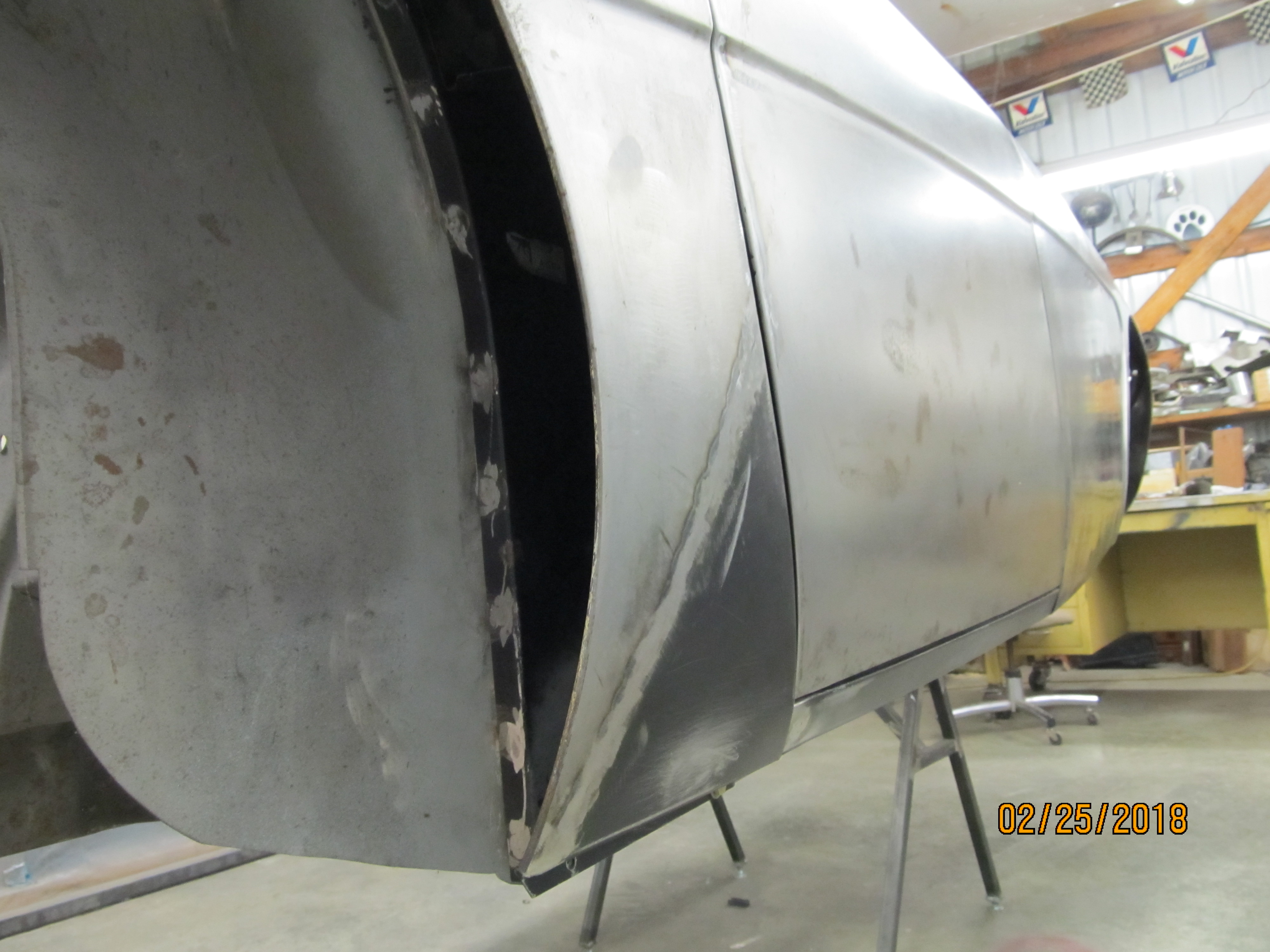

All wheel openings have wired edges to stiffen them and give a nicer visual - anything else would not look right. The option of with or without wired edges is to tailor the cost of the parts to what you need for any given repair. If you can cut away the rusted metal without cutting thru a wired edge, the degree of difficulty in welding a patch panel is exponentially easier. Picture of a rear fender dog leg where it was possible to leave the wired edge undisturbed (I did not need a wired edge on the patch panel therefore it was both much cheaper and much easier to weld).

Thank you so much for the pictures and the explanation - I hadn’t considered a repair that didn’t include the whole width of the panel - after looking at your repair my hope is that I’ll be able to do the same thing ( fingers crossed ! )

Red's welds looks like they were done with a TIG welder. You don't have to use filler material like a MIG, so the welds can be more flush to the surface. You can get that kind of weld with gas too. All this to say, if you MIG, you will be grinding.
Hi dblmtr, Greg is right, those are TIG welds, and the two advantages are controlling the heat and minimal filler. I used 3 or 4 stitch welds to keep the panels aligned and then a series of short welds that were backstepped. Stitch welding and backstepping are ways to minimize heat in a panel to control distortion (google for examples). After welding grind the welds down to smooth and then planish (slapper and dolly) to stress relieve and help the panel stay flat.
Grinding the weld down can add a lot of heat too and one trick to avoid heating the panel when grinding welds is to use a 4 1/2" grinder with a 1/16" cut off wheel held perpendicular to the panel, moving back & forth lightly so just the edge of the cut off wheel is in contact with the weld.
I do not recommend MIG welding for body sheet metal. Another common term for MIG is "wire feed" and in order to push the wire thru the tip and to the work surface, the wire has to ne a fairly hard steel. This leaved a very hard and brittle weld that is resistant to straigheneing after the warpage of welding - prone to cracking and generally difficult to work. Oxyacetylene and TIG don't need the hard wire so you can use a much softer filler material that is much easier to planish smooth. I have done some of this by oxyacetylene but the heat affected zone is much larger and the chance for warpage is greater.
Another way to reduce warpage is to try for as uniform a heat affected zone (HAZ) as possible - if you look at my picture you can see the outer edges of the HAZ are close to parallel. If you have one area with a much wider HAZ and another area with much narrower HAZ, you will suffer more warpage and therefore more hammer and dolly time to flatten.
