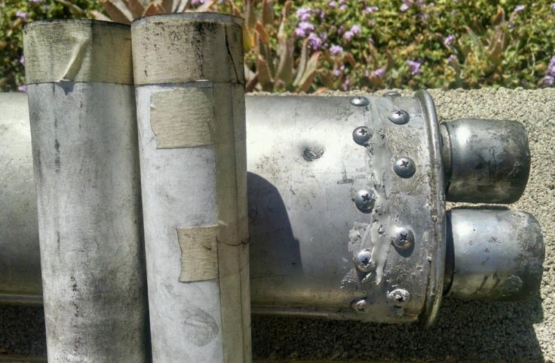

I can seal the seams with muffler sealant - like the guy did in the original Lotus posting.
Welding's another project entirely. This one can be done with screws. I want to be able to re-pack it in a few years if it gets loud again. From a little basic research, I'd say Randy's correct - the melting point of aluminum is too low for this application.
I sure hope you don't see those kind of temps at the outlet of the muffler.:rolleye: I think you will be fine temp wise but the heat and cooling of the aluminum to steel may cause accelerated corrosion and loosening of the screws, but is definitely worth a try.
Indeed, the strip of aluminum isn't going to melt, but I expect it will get annealed to the point of the screws losing their bite. That was the intended point of my previous post.

Understood. Will verify that and report back. Have sheet SS now and info on drilling and cutting it, but want to prove out the work I've already done before moving on to the SS. Maybe I need to find Grade 8 #10 lockwashers if such things exist. The Grade 8 LWs on my manifold studs have retained their temper.

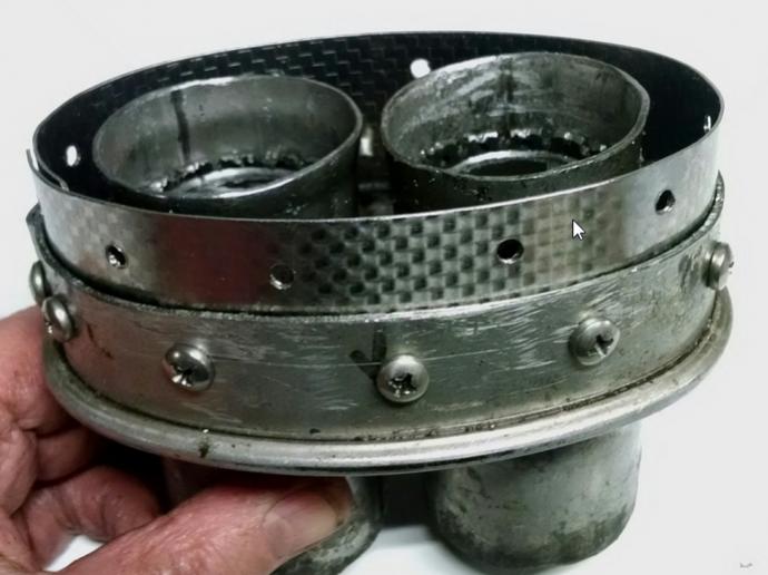

Got lazy and decided to replace the aluminum inner sleeve with SS. Will have an update pic tomorrow or so.
You can cut it with a hacksaw and water. Drilling - am using a cobalt bit at slow speed/high pressure with water. Threading is normal. Everything takes longer.
IMO if you cut the rear of the muffler off instead of the front, the aluminum would be more likely to hold up as it would be farther downstream and not as hot.

Redid the insert in .033" laser-cutable stainless sheet (it's what was available as a scrap from the metal house):
Thread strength seems plenty strong. Will use star lockwashers for final assembly with muffler cement. Still waiting for the Acousta-Fil.
SS was easier to bend than the AL, but drilling was harder with the necessity for slow speed and water.

Repacked the muffler today. Only needed one pkg of 350mm x 1m Acousta-Fil.
I made the two 28" tubes out of poster board. They made it easier (ift not easy) to slide the packing into the 27" long skinny muffler.
