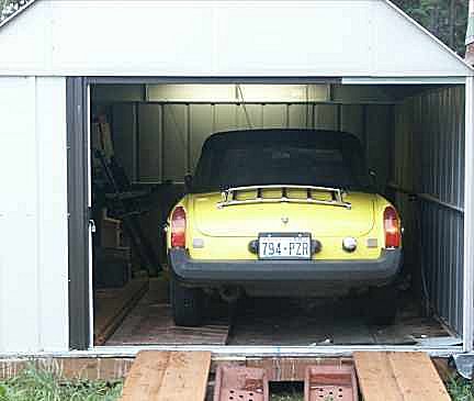

Well, it is too cold to work in my unheated "garage" (see picture attachment) so am just building up a folder of things to do and how to do them. Current question: How do I remove the chrome trim strips from the sides? I f there are clips or ? are replacements available?
