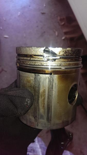

well, got two pistons off relatively easy. im shocked at how well this car ran considering the shape of the pistons taken out so far (see pic). question: is there a trick in removing the con rod from the crank? just cant seem to get the last two off. bolts and lock tabs came off easily.... but cant spread the clamps apart to remove. any suggestions?
