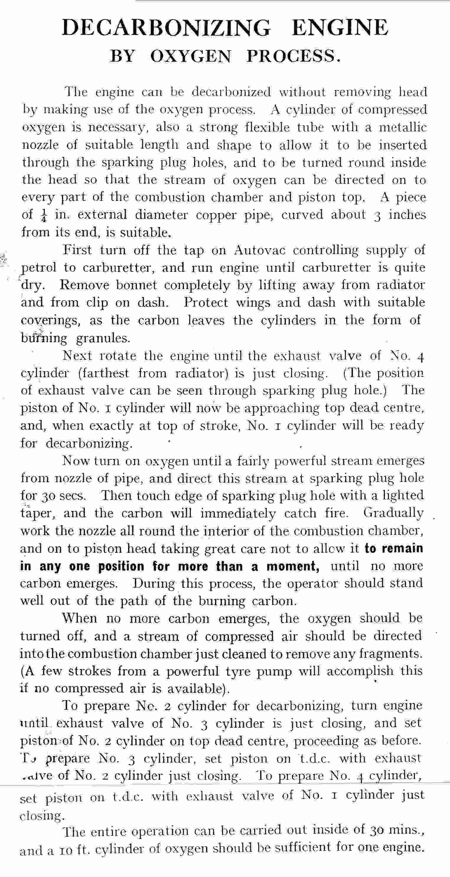

You might be amused by this excerpt from the owner's manual for my 1925 Rover 16/50.
Ken G, San Francisco
/ubbthreads/images/graemlins/eek.gif an interesting method for removing carbon....

Ken, that's downright funny. It was a simpler, more adventerous time.

Ken G,Nothing new about that, we have been using this technique for years but use an acetelene torch.---Keoke
