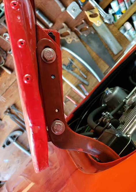

I think "indexing" is more reliable than using a sharpie. You do this by drilling two holes through the hinge and bonnet mounting as pictured on both hinges. When it comes time to reinstall the bonnet, insert the drill bits through the holes to line things up. Easy-peasy.

IMO replacing the bonnet using the index holes is trivial.
