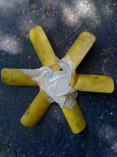

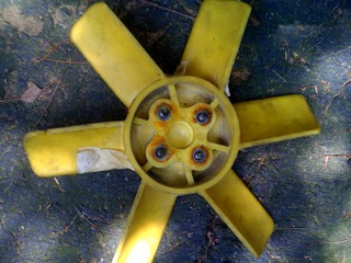

Photos of fan:
Only one way to install that fan (and it will "pull"!). :wink:
I just wanted to be sure that he wasn't putting a Mini fan on it!(pusher).
OK- I had thought that you said that it heated up at speed but didn't at rest but you are saying that it is OK at speed and hot at rest so- YES-- a bigger (plastic) fan IS the correct answer.
If you have a 1275 then you need the 1/4" spacer to allow you to clear the PCV tank that is attached to the timing cover, if you have a smaller engine then I am fairly sure that you just bolt on the plastic in place of the metal fan and you are good-to-go (no spacers necessary).
--And DON'T change the carb mixture in this case.
Bill
