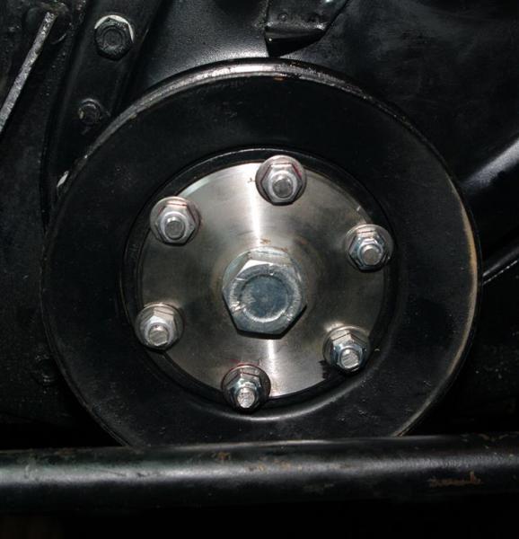

If you are planning to leave out the fan extension, be sure that what you put in its place securely clamps the pulley hub against the timing sprocket.
In that regard, the fan kit that I bought from Rimmers included a large aluminum plate to use for that purpose. Not as heavy duty-looking as the one from Rick Patton, but I think it should work OK.
