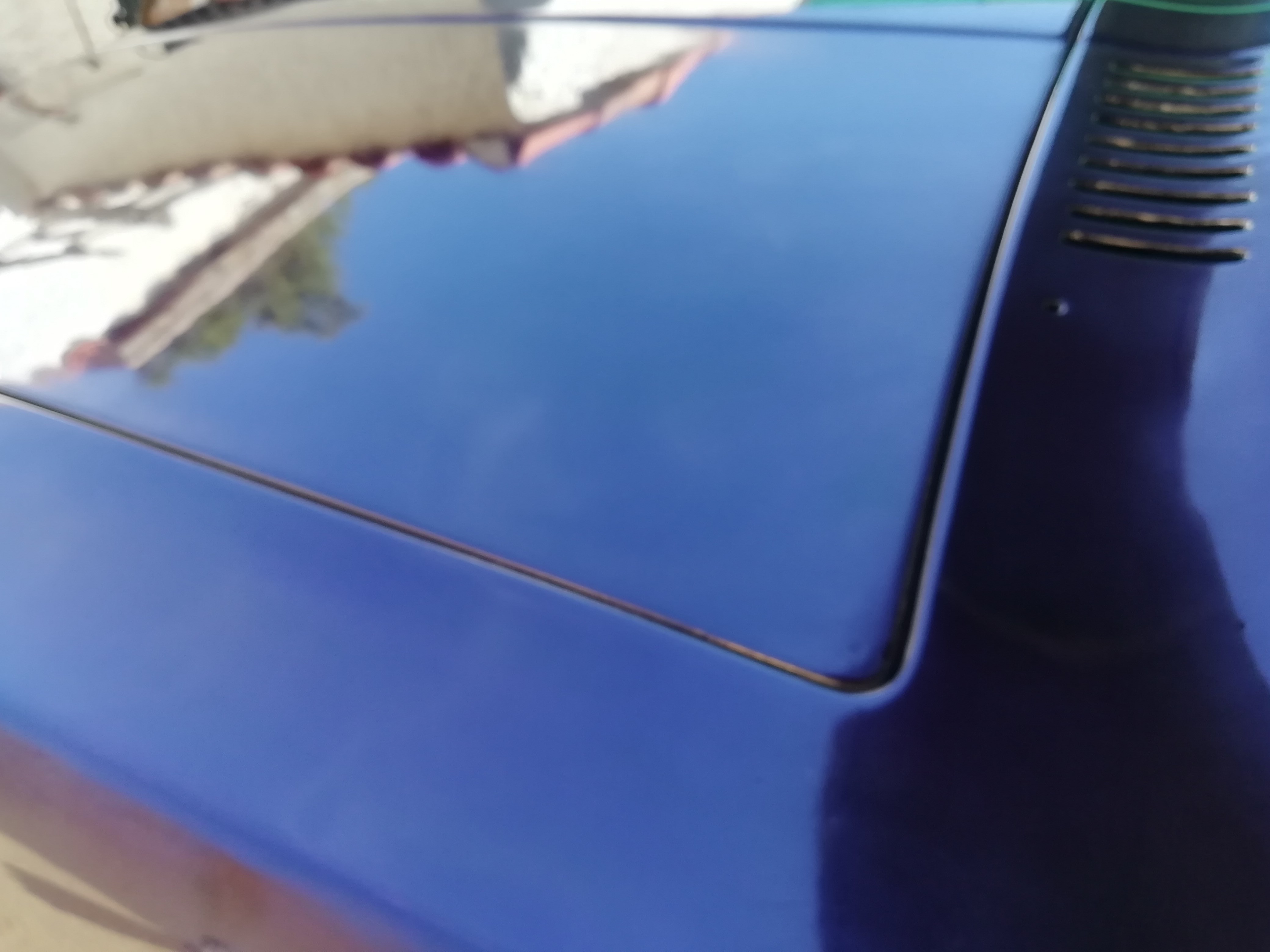

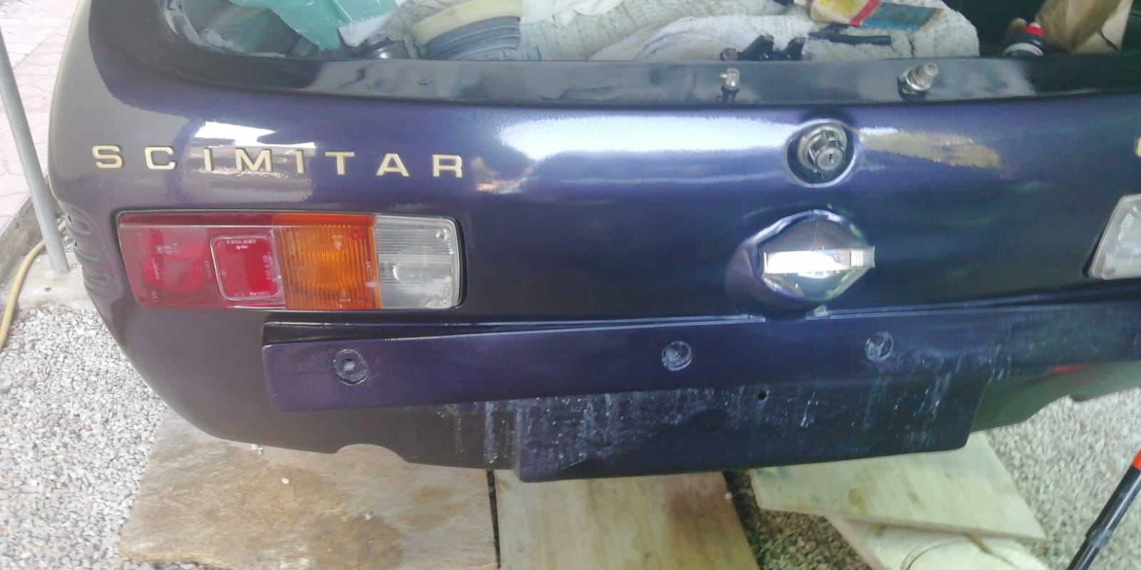

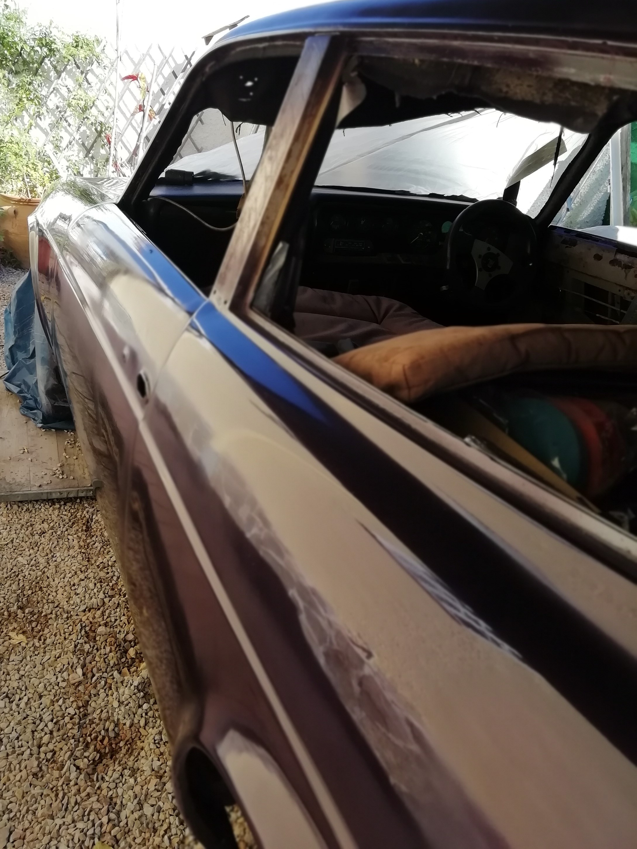

Just a few pictures of the refurb work on the body, first 3 are body colour getting ready for clear coat, last 3 are body work primed ready for colour coat 'Highland purple metalic'. Just before covering up as we are expecting a sand storm over the next few days, so don't want any of the work ruined.

Well, sand storm over with, followed by 3 days of heavy rain and strong winds. bodywork well ruined, some places it was down to the gell coat, so now, it's start over again, rub down all damaged area's, repair and back to filler primer coat ready for colour coat well 2 or 3 coats, leave for a couple of hours then 2 or 3 coats of clear, depending on how it goes weather wise. Leave it to harden for a week or so then cut and polish. That should hopefully be done by the first week in May. That will leave re-assembly of the engine and gearbox, plus other bits and pieces, ready for road test hopefully by August all being well.
Don Riicardo
Don Riicardo
Well at long last we are back to working on the Scimitar, the car has now received it first coat of base paint, and then the compressor started to playup, I found a split pressure hose, so the relacement arrived tomorrow. It is now hoped that by Sunday evening clear coat will be on and thats it, leave for a couple of days to harden and then buff it, start the re-assembly. Not bad for a year behind schedual, but at least we are getting there.
