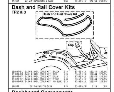

I am in the process of recovering an extra dash that I have for my 3. I have noticed that on the old dash there are a few small clips that seem to help hold the old covering in place at the bottom. Is this something that came with the car or added later? I cannot find them in any of the big 3 catalogs.

I have a spare dash that has those clips as well. They look pretty close to the 2nd picture that Woolies sells: Edge clips

MGTF1250Dave
Aloha Russ,
The clips are available from Victoria British, part # 14-959. It is on page 57 of their TR2 3 4 & 250 catalog.

MGTF1250Dave
Aloha Russ,
Your welcome. It has been awhile since I bought them, but the ones I got are like the ones described by Geo. I don't think the catalog illustration is accurate.

I just found them in the VB catalog, oh and by the way what a great place to drive your 3 or the TF.
