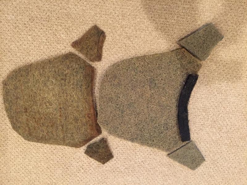

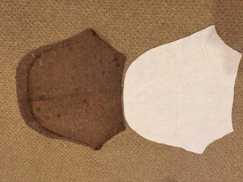

Whitephrog
attachment.php
attachment.php
The squab on the left is OEM. The squab on the right is new AHSpares XUPY152.
The back of the back piece on the left is OEM. The piece on the left is my felt homemade version.
