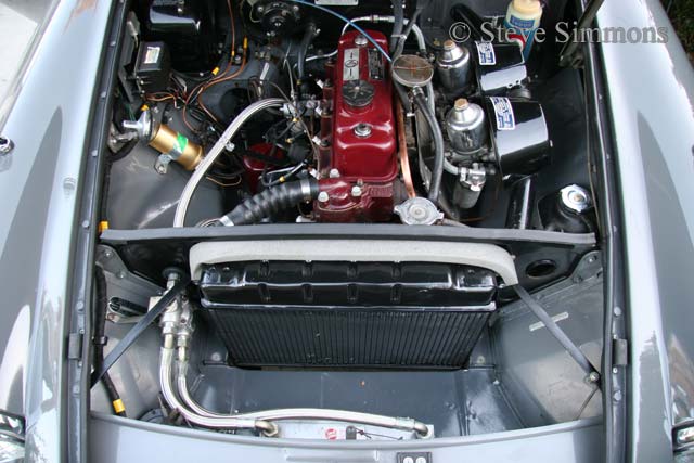

So your rad has a copper core, extra rows, and it fit right under the hood?
Sure did. One shop told me they couldn't fit a 5-row core. Another shop said they do it all the time, and their core fit beautifully.

That looks sharp and is encouraging. You've got a different filler and overflow setup than I've seen before.

The radiator tanks and filler are stock '67. The overflow tank mounted on the right of the photo is from a Mark 2 car, which allows me to run a pressurized cooling system.
