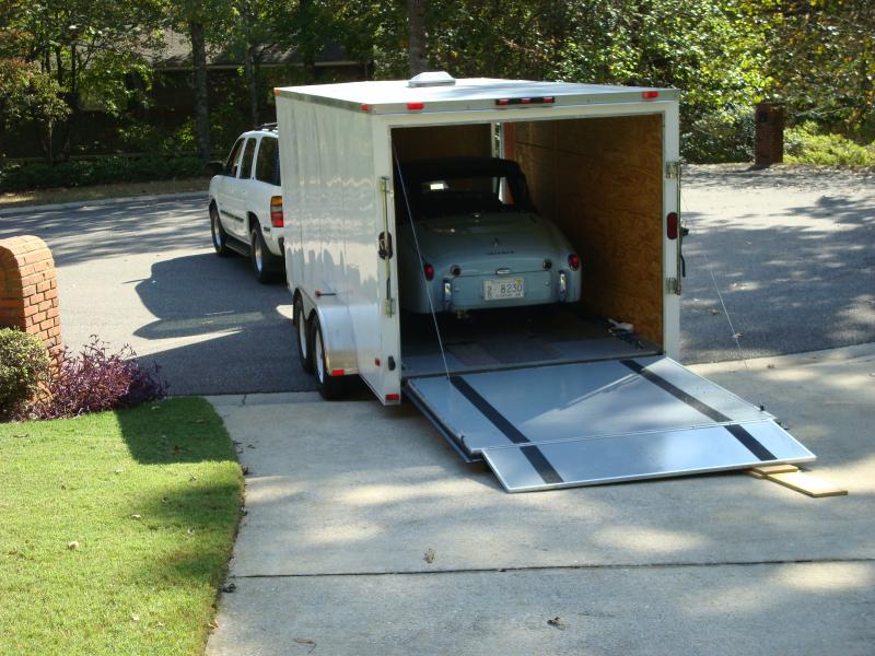

i have a 7'x16' enclosed trailer. The TR3 and the 250 fit. It is a little time but like Charley said tie down point locations are important.
I carry my MGTF in a 16X7 Box trailer, not much room on the sides to get in and out, but doable. I have carpet on the sides in the door area just in case I bump one of the doors. The rear door is a ramp type. PJ
Hi Paul
I am looking at a H & H 7 x 16. The salesman says the ramp is good for 1600 lb. Others I have looked at say 1000 lb. Can you load your TF without any problems? I worry a little about bending the ramp. I am thinking of making a couple extra ramps on the door to reinforce it. Not to worried about the TD, but I think my TR3 is a little heavier. What has been your experience?
Gary
I carry my TR3 in a 16X7 trailer that was made for the car; torsion suspension, heavy frame and ramp, and tie downs properly located for the car. During the past five years I've made many long trips with the rig and never had a problem. I would not recommend a trailer any smaller.
