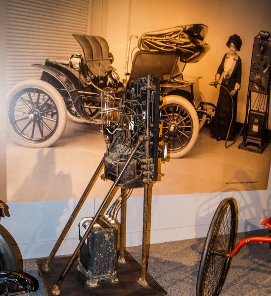

Wow - that's quite a contraption. Do you have any photos of the front, or any instructions or history? Interesting photo of the "petite young lady" doing her own refill.
Tom M.
Tom,
I might have other photos, but I knew that I had this one taken just before the museum opened. I will try to track another down, or take some more for you on my next trip into the museum. I feel like the old Frankenstein movies just put a bunch of these old chargers side by side for the props of the doctor's laboratory.
