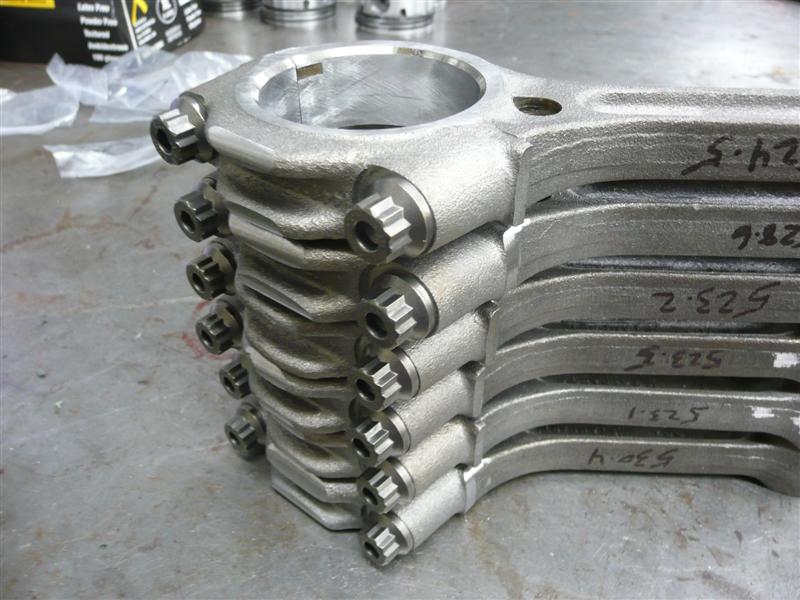

Paul, on your website, you used ARP rod bolts and there's a comment that you had to have the caps modified to accept the ARP bolts. Why did they have to be modified? Thanks, David K.
Brosky
Re: Rebuilding TR-6 Engine - Questions, Questions.
David,
They had to be machined a bit to allow the larger head size to fit onto the rod caps as shown here.
