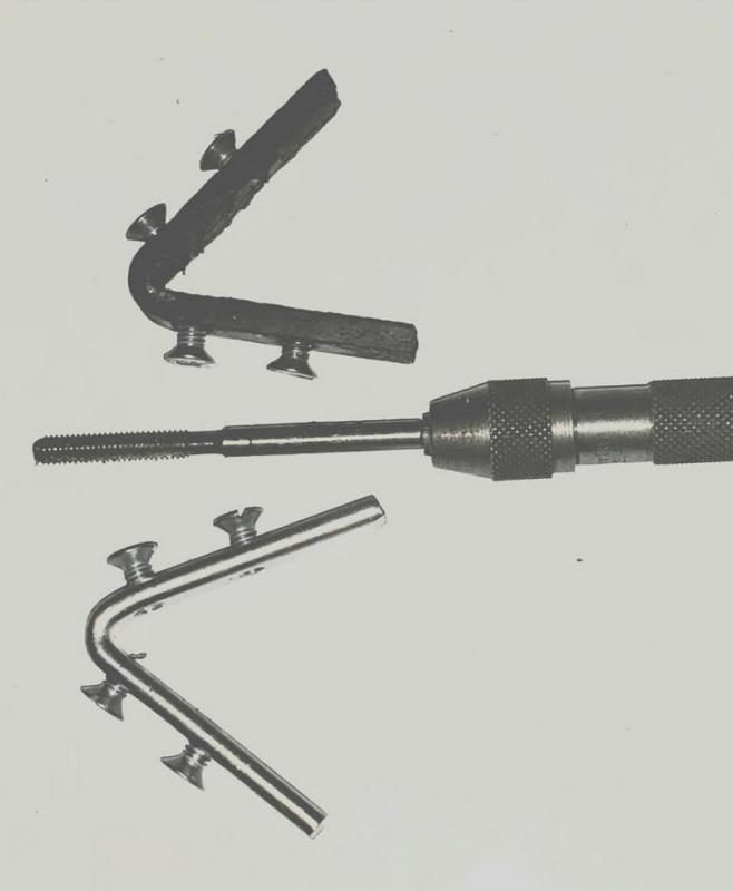

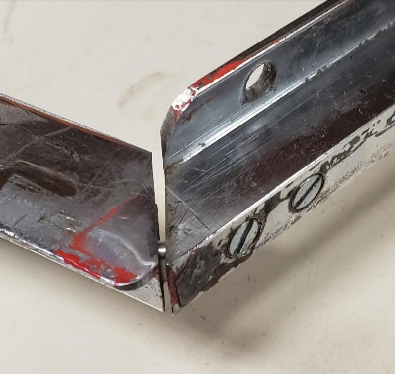

I found these (Moss from AHspares) do not fit; neither does the filler strip:
Drilled & re-tapped existing corner brackets. Screws are 6-40
Edit: was able to find SS socket flathead 6-40 screws on eBay and 1/4" X 3/16" adhesive-backed rubber stripping at Grainger.
The ones I got from Moss didn't fit either. I was able to reuse the old ones. I was using new glass, so the sealing rubber fit.

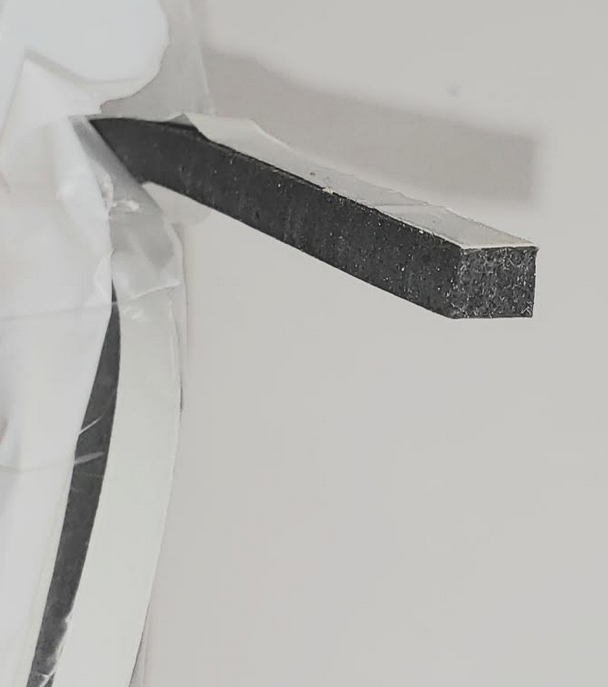

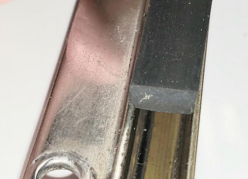

Replacement for Moss Filler Strip PN 682-027 which did not fit per pic above:
Grainger PN 497L42 Rubber strip, 3/16" Thickness, 1/4" wide, adhesive backing, Length 10ft.
Also available cheaper without adhesive backing.

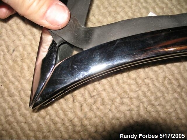

Randy,
Referring to your picture:
1) Did you miter-cut the rubber seal at the corners of the glass, or was the seal stretchy enough to just force the frames onto the glass over it and have it wrap around the corners without any cutting?*
*Edit - never mind, I see above you didn't miter it. I should read more carefully.
2) The part you're holding away from the glass - what did you use to cut it next to the frame.
Steve
my memory sucks but as i recall i stretched the rubber over the corners pretty easily. the glass corners are not real sharp.
on the rubber:
one reason i cut it back to an 1/8" reveal, i had less of a bubble of the rubber at the corners. either way if you cut the rubber at the highest point (see Randy pic above) to the metal; let one piece lay over the other and run your knife thru both pcs at one time. run it from the frame corner out to the the inside point where the rubber overlaps. pick out the loose pcs and you will have a perfectly fitting miter. i used a dab of clear silicone at the corner.
hope that is what you were asking
Steve

OK, DD, I now understand that you mitered the corners. Not just squishing the corner seal in place with the metal frames.
It appears Randy squished the continuous strip in the corners with the metal frame pieces.
