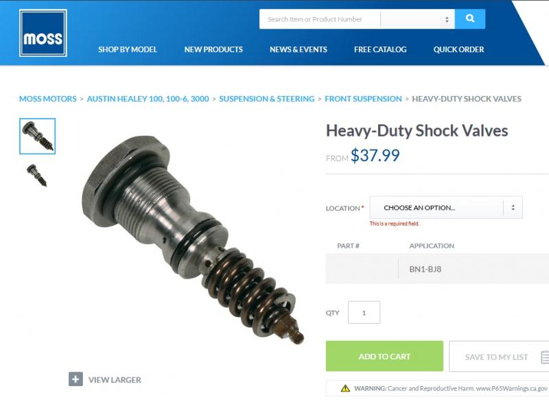

FWIW the valves are available for front and rear and are easy to change.

Ok Steveg,
Good to know Moss has those and I understand the possibility one can adjust the tension if desired, yes? My lever shocks were also leaking out the sides. I just figured on sending them out since there was not much in the way of videos on how to do yourself. I gave up this time. At some point, I want to have my rear lever shocks redone (if they need). I will inspect in the future. I have found videos on how to refill with fluid. Any good tutorial videos out there on how to rebuild? Otherwise, WWAP has done a terrific job. I have no problem using them again. But, for the sake of argument, I enjoy the restoration process of doing myself. So far, only three times I've had to have somebody else do work relating to my car...Polarize my existing generator from positive to negative (first Healey), balance my tires and now my shocks.
