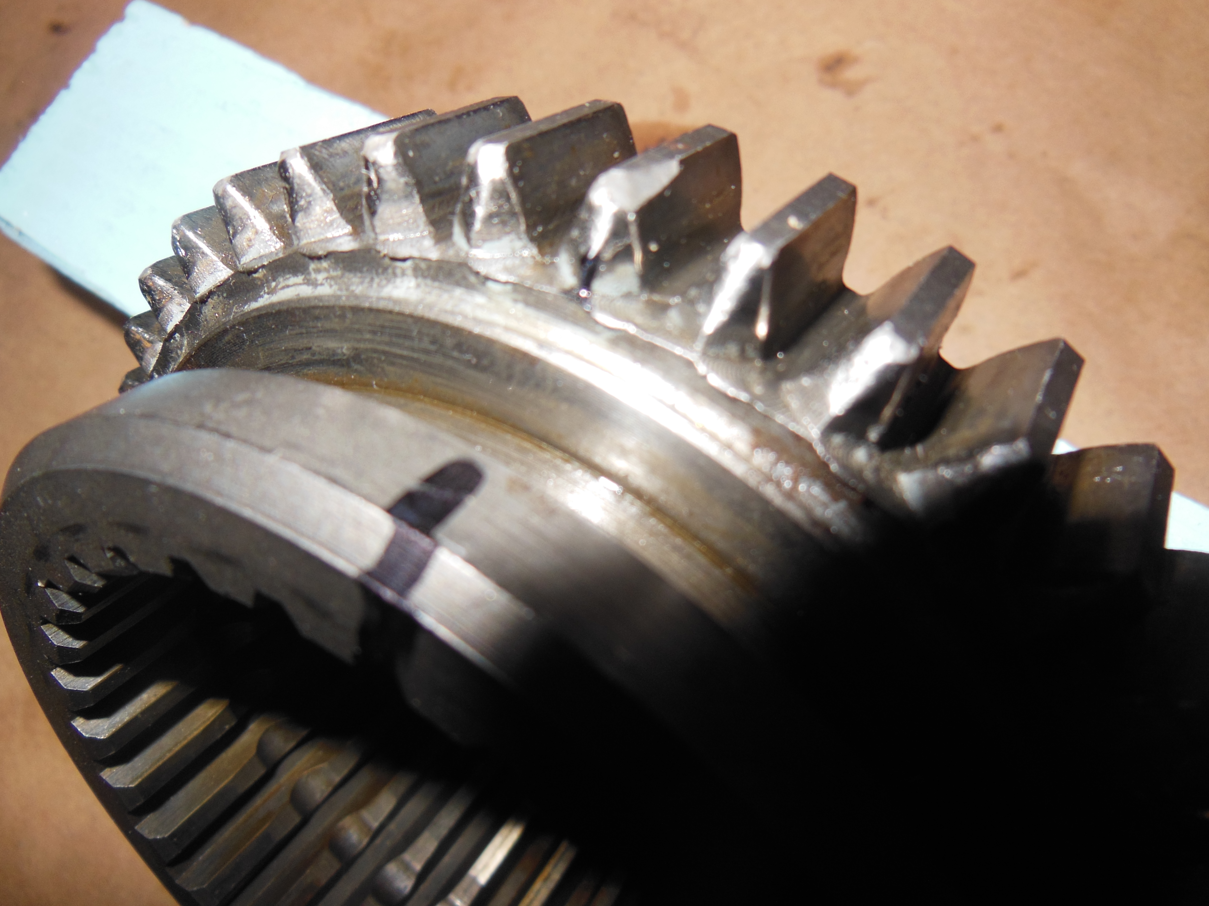

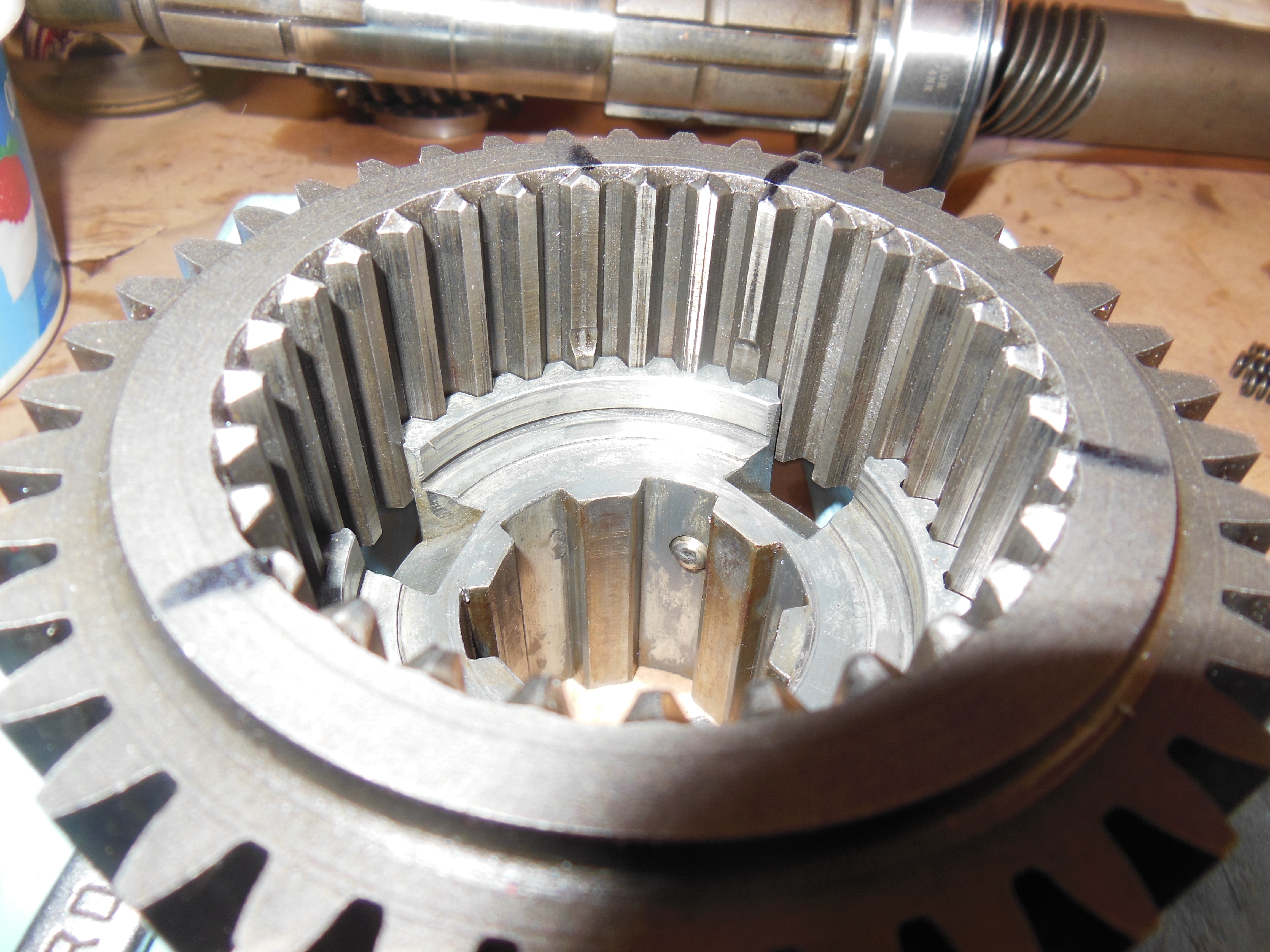

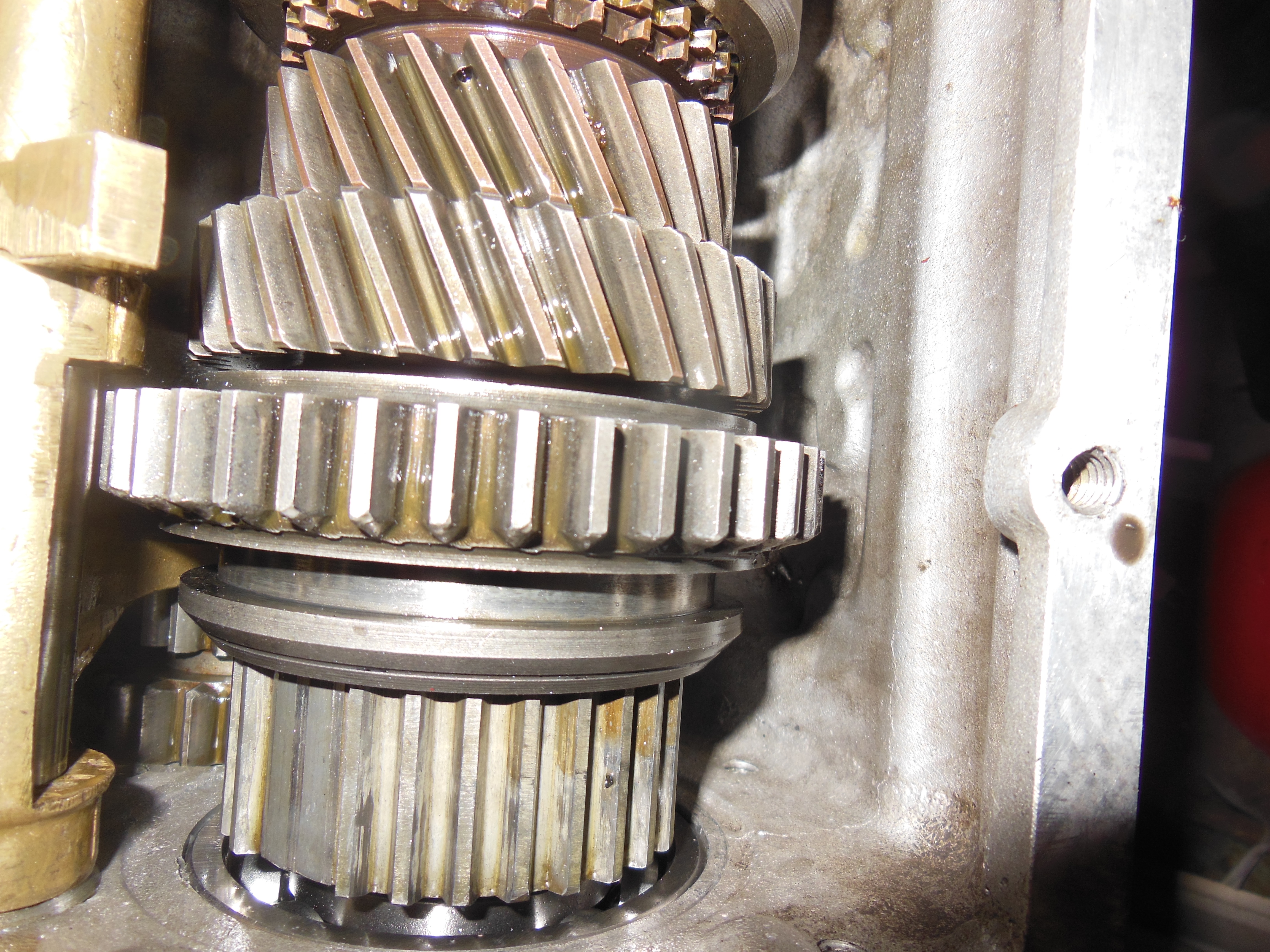

On Overdrive and non-over drive transmissions all the gears are the same? After move investigation, I really do not like the first/ second slider I was going to use in this rebuild. It has a chip in one of the teeth about a 3/16 long and about 20% from the top is missing. The chip might grind down even and mesh fine. It seems to me there are many teeth on the slider and perhaps because there are many teeth, a grinding of one tooth might not be noticed.

3/16" is a rather large chip. The problem with large chips is they serve as stress risers, which can start cracks. Of course, cracks eventually lead to a failed tooth, which would cause the real damage.
I cannot get a real good picture of the chip, but here in the best. I am going to use a different gear and slider anyway, so not too important. Taking a drumel and feathering the chip might be doable never did it before. I started looking at the sides of all the teeth, and can see what I believe to be some kind of stress fracture or something, maybe wear.

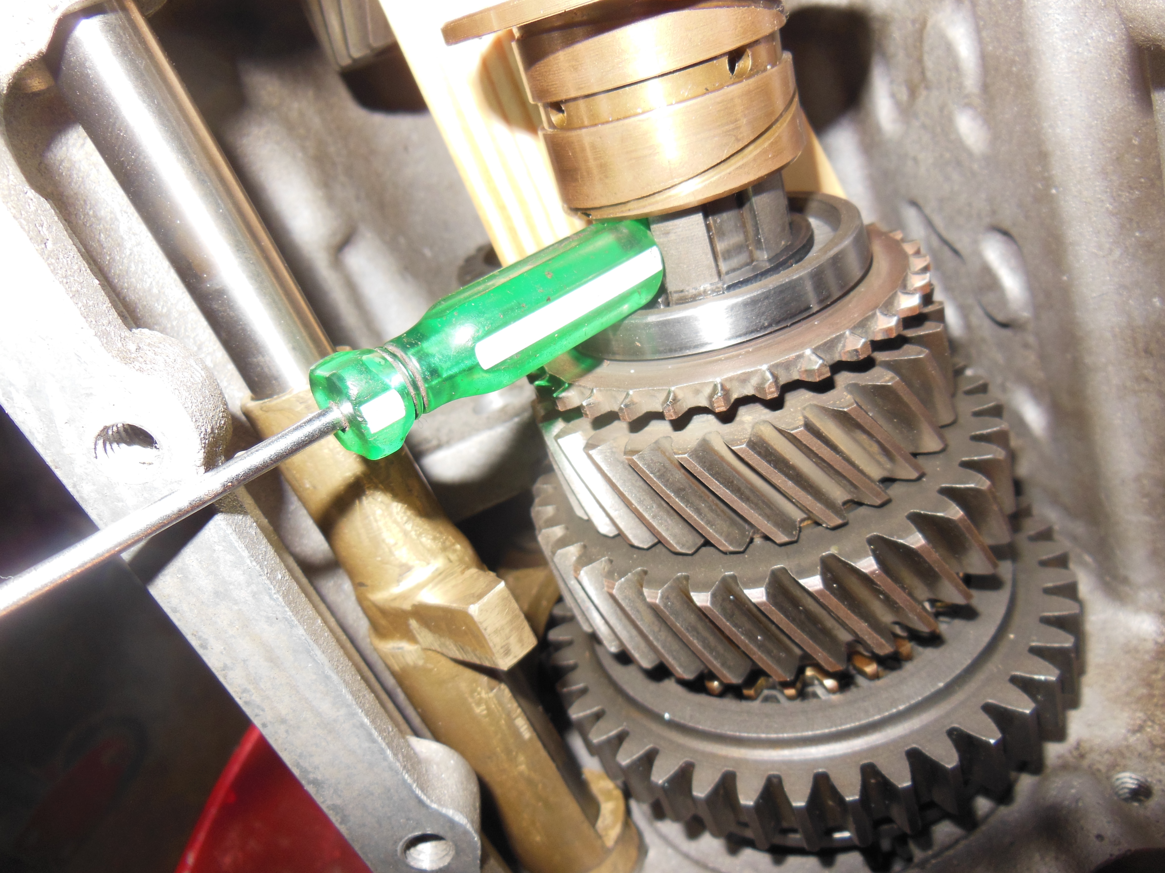

Anyway, I put the gears on the shaft and started to slide on the circlip using an old Top Hat bushing and piece of pipe. I thought heck, if this circlip goes on, it could take some real fun time to get the clip off if anything is wrong. So, I am back at the computer thinking what did I forget. there is only hand full of gears.

For you guys that cannot sleep until I push the circlip down, I went ahead and push it into place.

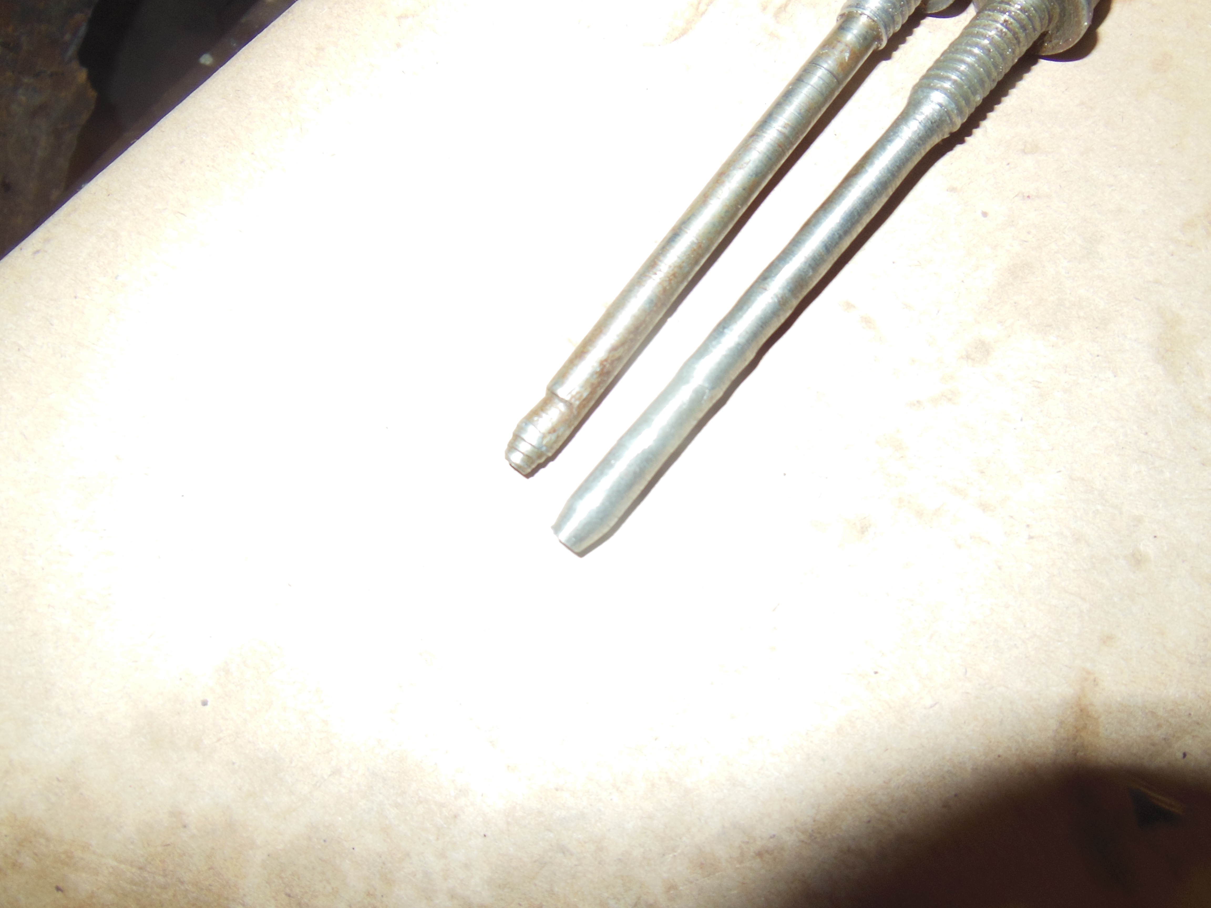

Does anyone know if on the long 6 inch bolt that holds the lay shaft still, would mig welding and grinding be sufficient to fill in the gap on the long bolt?. I would think so, but I do not know. Every stock bolt I have is missing a big chunk of the bolt. They do sell one for 20.00.

Looking good! All the wear on the long bolt shows how much that shaft tries to roll. Mig will be tricky, but I am sure it can be done, then just grind it back to shape.

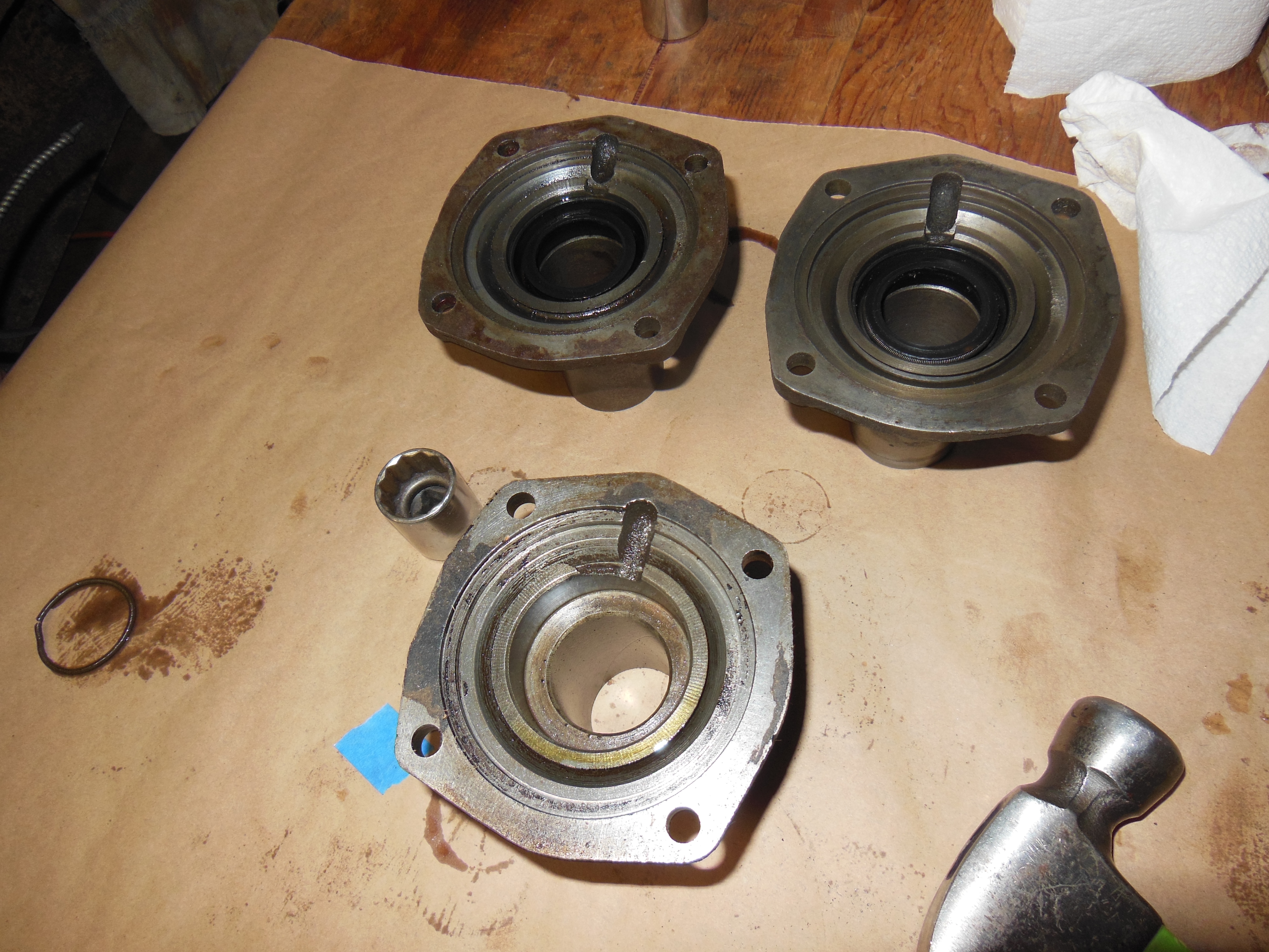

I am having difficulty removing the front seal. What are some of the ways other have removed these seal.

I think I've done it a couple of ways. I usually start by trying to catch the edge with a punch from inside the slip collar to loosen it. Once that just rounds the lip of the seal, I go with holding the cover in soft jaws and then using a big screwdriver to pry.
I did get the seal out with collateral damage. It is difficult for me to go caveman with a screw driver sometimes. Years ago I scratched a diff seal and it leaked, bummer. I tried all the stuff on line and none of it worked. I am thinking one of the pry tools might work if it is sharp and longer. Mine broke trying to get a seal out.
Now I am thinking perhaps some kind of tube cutter at a 45 degree angle going around the outside and scoring the seal metal at the bottom inside with all the rubber cuts removed might weaken the seal metal enough to pull it out.
Or I am thinking burn the cuts out of the seal and see if I can weaken it enough with heat. Those seals are so stuck; it is like a pressed in tin can bottom.
Steve
When I have removed them, like others I have pried and punched. The seal itself was a total mess by the time I got it out.

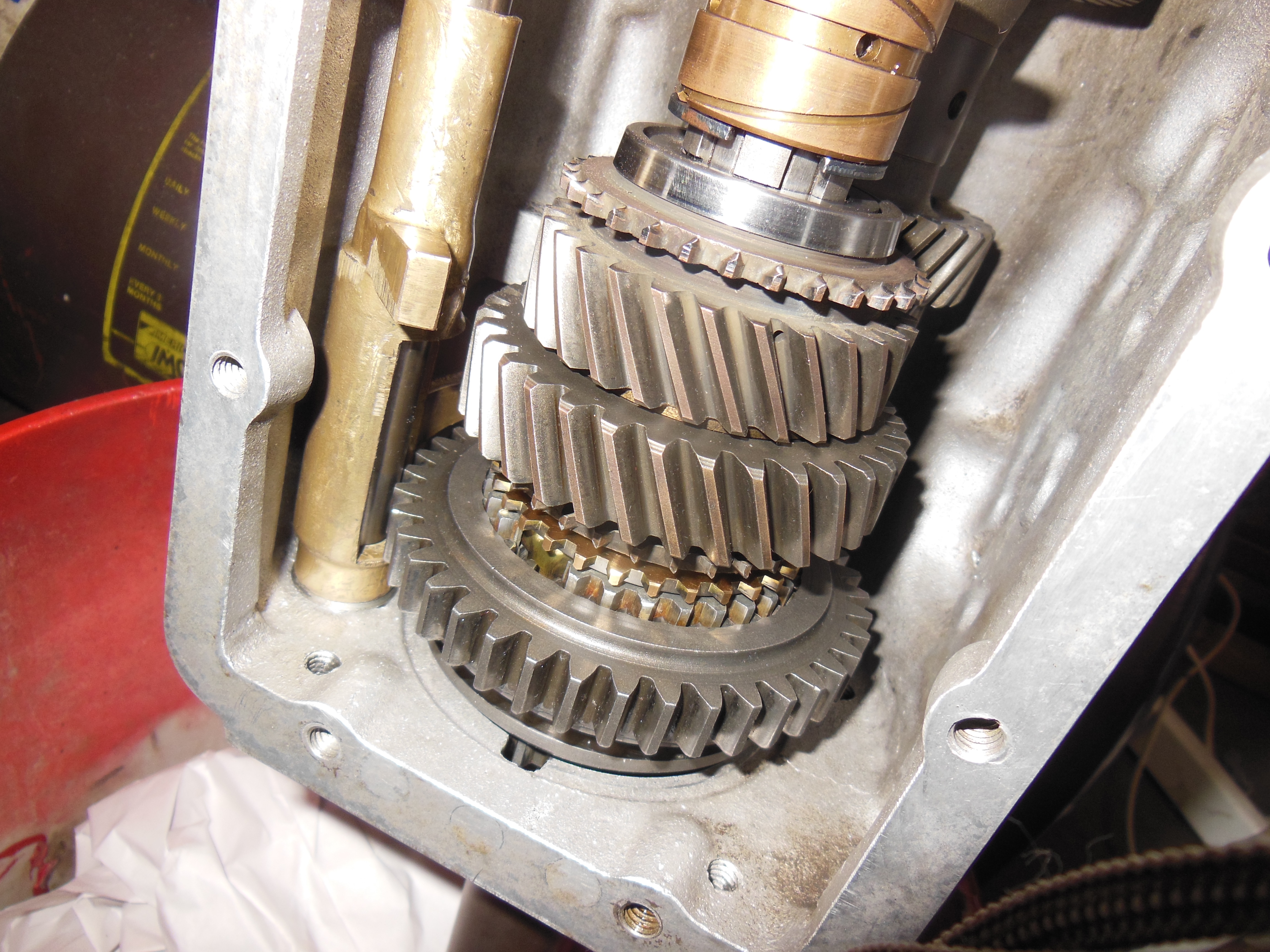

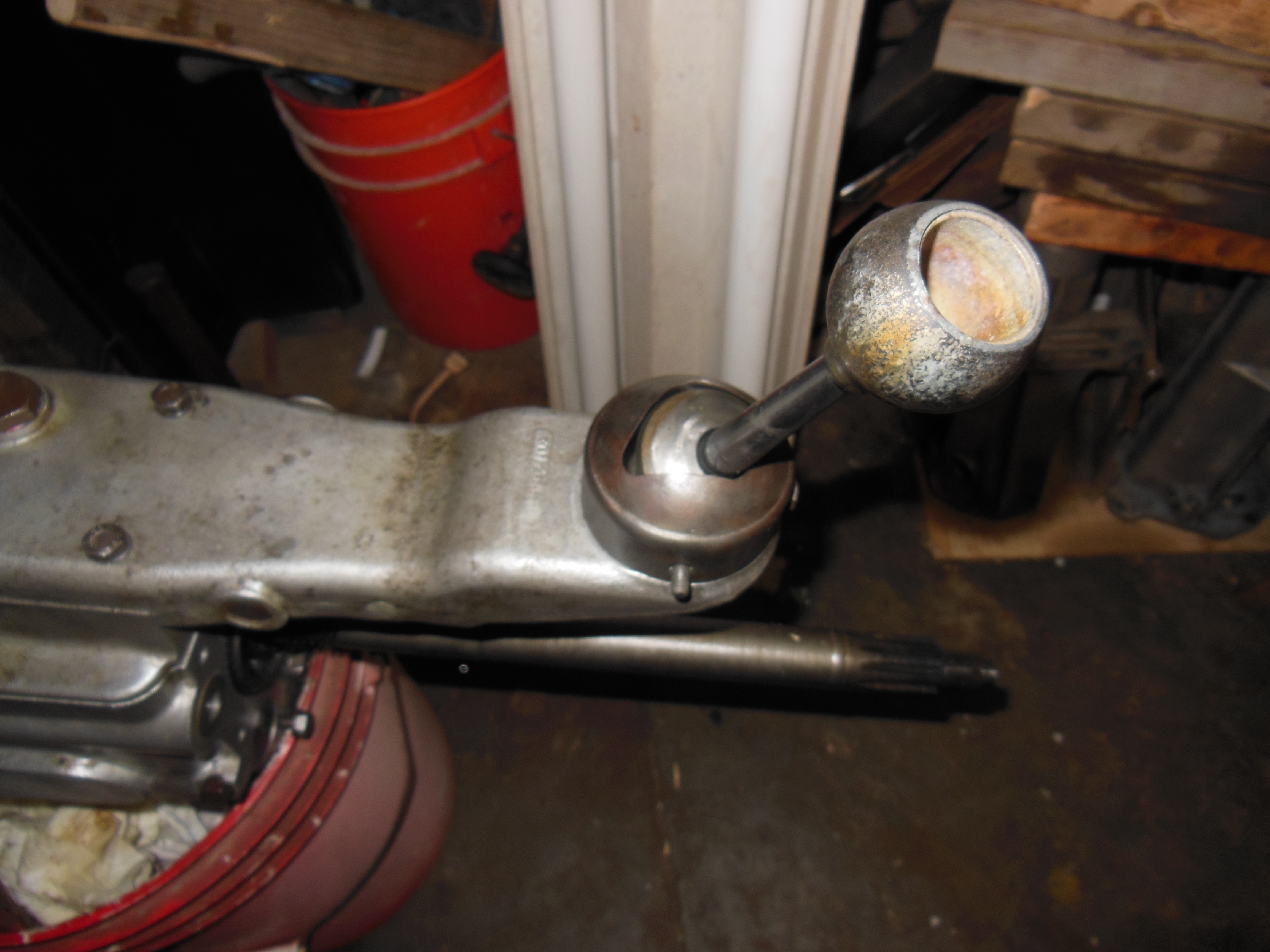

I got the trans put together and mounted the shifting tower that came with that transmission. When I was working on the transmission, I worked with the dedent balls and tried to get a fish scale tool to help calibrate the force. The tool came damaged a little, and I could tell right away this was not going to work me. I decide to replace the balls and springs and call it good.
I Pulled the tower off carefully after I shifted into second. When I shift into second, there is a good holding force, I trust that is going to be enough. There is a small gap between first and second gear maybe a 1/16 or so seems like there should be some, right. The gears shift fine and tight when it is not running, but it needs to be driven to understand the quality of the rebuild. I probably should put new springs in the shifting tower assembly before I quit.

Well, that finally answers that question. The answer has to lie within the shift cover balls and detents.
