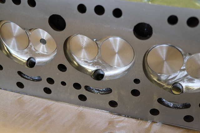

- Head. Would love to have DW's Al head for the weight loss if nothing else, but it's an awful lot of jack and I don't know what I would gain with an otherwise stock setup. Would also consider getting the stock head worked over by someone who knows what he's doing (not me).
- Headers. See 'head.' DW claims "The twin carb manifold will make the single most increase in power and torque possible for the money spent to a standard car." I'm concerned about installation issues and, though I've never run any car with tubular headers I have seen issues with tubular exhaust manifolds cracking (the Jeep I6 engine is notorious for this). I also wonder how an exhaust can be installed without the flex tubing found on stock down pipes--won't vibration wear on the headers or exhaust? If I don't go with headers, I will have the manifolds ceramic coated--would do to headers as well--if for no other reason than to (try to) prevent the stumbling due to vapor lock on hot starts due to ethanol in fuel (had the opportunity to buy ethanol-free premium gas in Oregon this trip, and didn't get the stumbling so I'm convinced ethanol is causing the problem).
