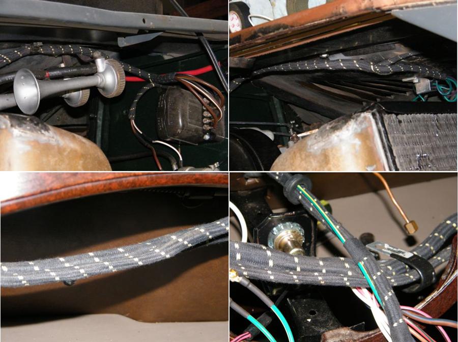

I had my custom, homemade harness for the Prefect bound at Rhode Island Wiring last year. Not cheap but they did a beautiful job. They charged a one-time $5 setup plus $4 per foot. I thought it was well worth the price. Here is a composite sample as I am in the process of installing it, two under the bonnet and two under the dash. Yes, that one wire taped outside the harness was my mistake, added after I received it back.
So, when you send a harness to Rhode Island Wiring do you just tape up the sections that belong together and mark where the harness would split off?
Right. I taped mine at about 6 or 8 inch intervals and carefully taped each branch where necessary. I also included instructions to stop the braiding at the last tape at each end. I also phoned to discuss all this first and got any advice necessary. They were really helpful.
