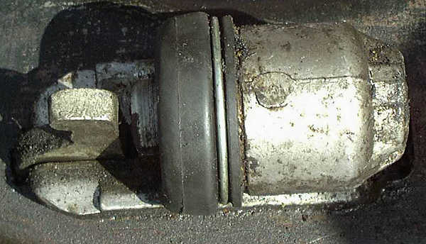

On Rick's thought, here is a shot of my brake cylinder. Note where the parking brake lever rides between the piston and the shoe, well, if the shoe was there to the left of the parking brake lever.
Are the pistons in the cylinders back to front... I'm totally stumped as to how the pistons can travel about an inch without the shoes contacting the drums. They shouldn't be able to travel more than about 1/4" even if badly adjusted.

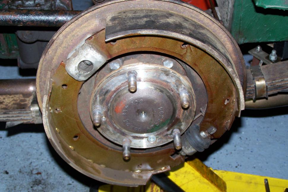

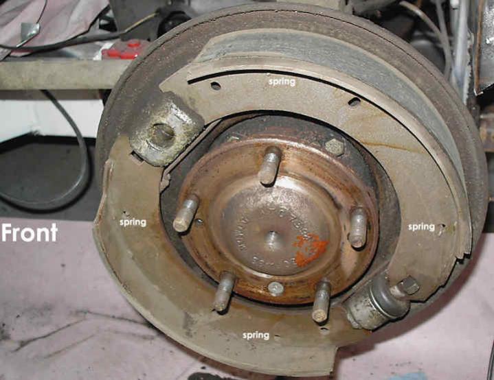

Hello Jeff, At this stage maybe its best if you post some clear pictures of what you have going on there! Then someone may I.D your problem! Did you look at the picture of my BN4 brakes i posted for your reference?
Could you guys send me an actual picture of your rear brakes? I'm running out of ideas and I'm wondering if I just made some little mistake. Thank you all for your input! Thanks, Jeff
don't want tp sound like a know it all but if you have everything on right tje piston can't move that far as to be pushed out ,make sure you have the right parts and that its a bj8 rear end ,you have to post some pics or your not going to get too much help
