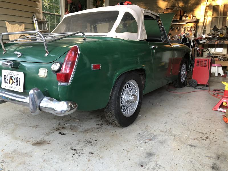

My most recent project with my 69 AH Sprite is tire scrubbing, specifically on the right hand rear side. I have a set of 13" wire wheels on this car. The sidewall of the tire is rubbing against the side of the fender on right hand turns and curves. My current measurement between my two rear tires (center of left to center of right tire) is 46". I think I'm sitting wide? I started out at 46.5" wide, but discovered that the lug nuts that the previous owner had were oversized, and the rear wheels were actually rubbing against the lug nuts, yikes! I have the right size on now, and can confirm that the wheels are sitting on the hubs, and not touching the lug nuts.
After fixing that, I gained half and inch, and the rubbing issue has diminished, but is still a problem. If the car is sitting flat in the garage I have about 1/4" space between each tire and side of fender. Driver side might have a bit more clearance than passenger, but they are close. Also on right hand turns, I'm hearing a bit of a rattle maybe even a knocking noise accompanying the scrubbing.

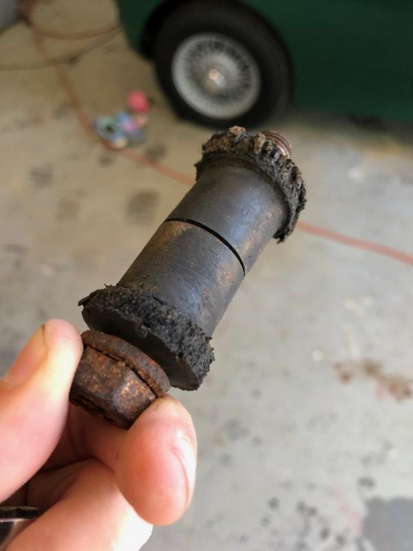

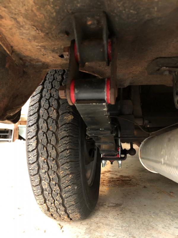

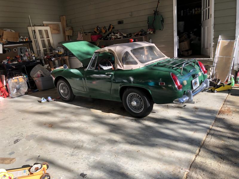

Got the new springs and bushing on the Sprite on Friday. That did the trick. The old springs were completely worn out, and the bushings were completely shot. I've attempted to attach a picture of the bushings (not sure it's gonna work). The rear sits about a inch higher now, and feels completely different on the road! No side to side movement at all, and a much smoother ride. With the rear sitting and inch higher where it's supposed to be, and with the new bushings in, I've not had any more tire rubbing issues. This issue appears to be solved for me. Now on to the next. I'll try to attach some pictures.
